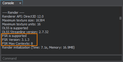

The upscalers are initialized on render initialization. To verify whether they are supported and initialized after application startup, you can do one of the following:
  • Check the Render section of the console output.
  • Run the dlss_info and/or fsr_info console commands.
For example, the Render section may provide the following information:
Source code
---- Render ----
DLSS is supported
DLSS Streamline version: 2.7.32
FSR is supported
FSR Version: 3.1.3
FSR Max Contexts: 8
FSR RAM Scratch Size: 10 MB

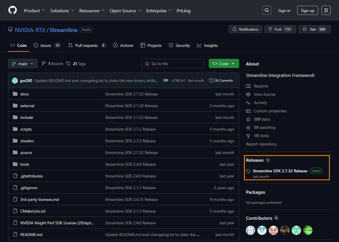

  4. Switch to the repository homepage by clicking Streamline as you did previously.

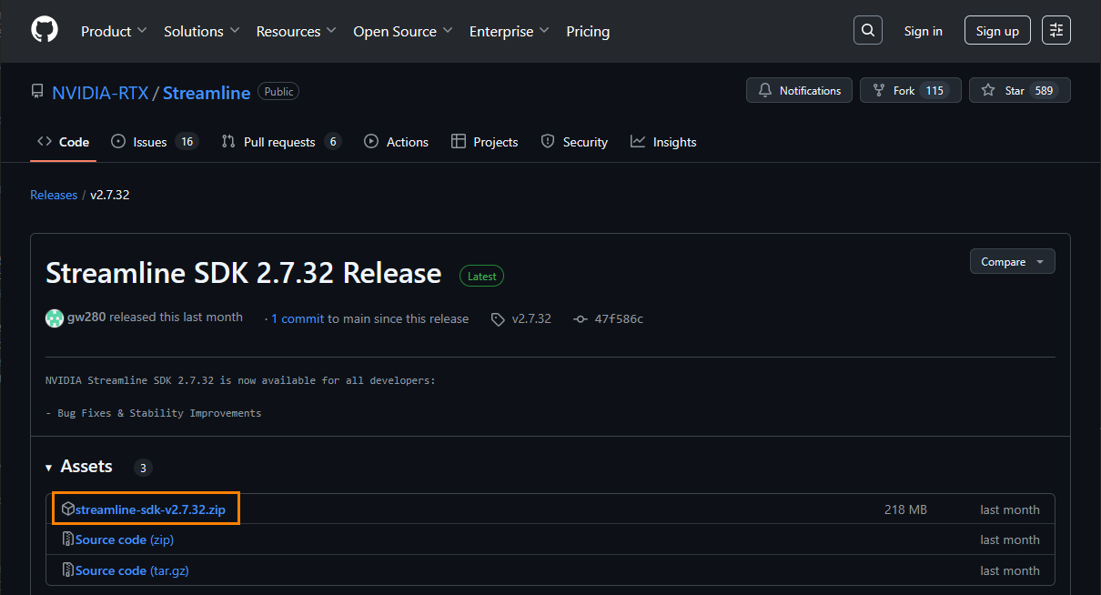

  5. Download Streamline SDK 2.7.32 Release. Click on the Releases link:
    Find Streamline SDK 2.7.32 Release and download the archive:

  13. In UnigineEditor, open the console and check that DLSS is available. The corresponding information is provided in the Render section:
    If DLSS is not available, the corresponding message will be shown in the console.

Before applying FSR 3 upscaling, you should check if it is available. In UnigineEditor, open the console and check the information provided in the Render section:
If FSR 3 is not available, the corresponding message will be shown in the console.
