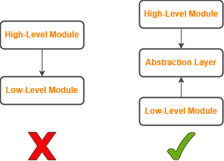

Dependency Injection (DI) is a way to write code that's flexible and easy to manage. Rather than creating or directly referencing its dependencies, a class receives them from outside.
Classes depend on an abstraction (an interface or abstract class) rather than a concrete implementation. This approach adheres to the Dependency Inversion Principle (DIP), which states that high-level modules should not depend on low-level modules; both should depend on abstractions. Moreover, abstractions themselves should not depend on details – the details should depend on the abstraction.
By following DIP, you reduce direct coupling and make it easier to replace components without affecting higher-level logic.
Abstraction diagram
To address issues above and build more flexible, testable, and maintainable systems in UNIGINE, you can use components that implement interfaces or inherit from abstract classes. C# Component System supports this approach and makes it easier to program to abstractions rather than concrete implementations and decouple components from specific dependencies.
