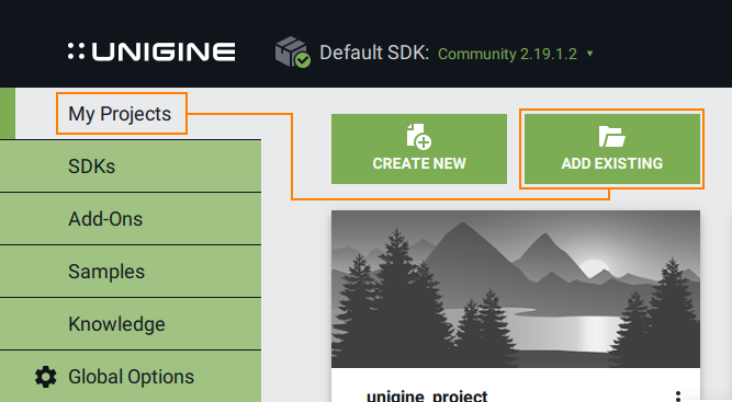

  3. Add the sample project to SDK Browser:
    • Go to the My Projects tab
    • Click Add Existing then select the *.project file located in the cloned sample folder, and click Import Project

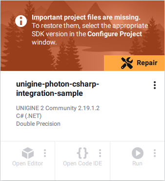

  4. Repair the project
    • After importing, you'll see a Repair warning - this is expected, as only essential files are stored in the Git repository. SDK Browser will restore the rest
    • Click Repair to let SDK Browser restore the required files
    • When the configuration window opens, click Configure Project without making any changes

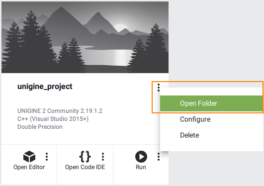

    You can quickly access your project via SDK Browser by clicking the three dots next to your project's name and selecting Open Folder.

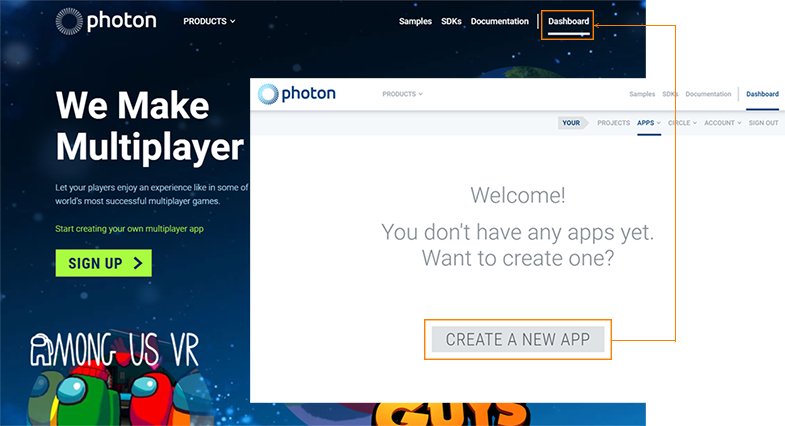

  7. Create App IDs in Photon Dashboard:
    • Go to the Dashboard at www.photonengine.com (the tab in the top right corner) and click CREATE A NEW APP
    • Create two applications for this sample: Realtime Photon SDK and Chat Photon SDK
      Creating a Realtime Photon App
      Creating a Chat Photon App
    • Use the generated App IDs in your sample project. The same ID is used for every instance (i.e. other participants don't need to create their own apps)
