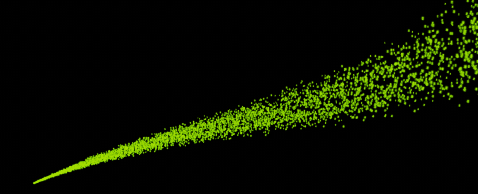

If you launch the application, you get the following particle system:
