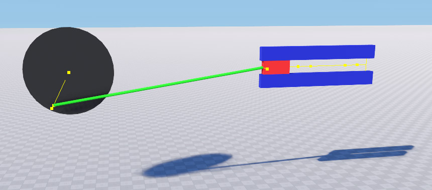

Creating Geometry and Adding Some Physics#
The first thing we are going to address in this tutorial is the geometry of our mechanism (see the picture above). We are going to create the following parts:
  • Two blue guide bars
  • a red piston
  • a green rod
  • a black wheel
  • Two dummy objects with dummy bodies to attach the parts of our mechanism to.
We are also going to add some physical parameters to the geometry such as mass and collision shapes. So, we need a set of basic functions:

Now using these functions we can create our mechanism. We are going to use MeshDynamic objects for the parts and Dummy objects for mounting points.
// creating parts of the mechanism
Mat4 transform = Mat4(translate(0.0f, 0.0f, 10.0f) * rotateY(90.0f));
piston = createBodyBox("piston", vec3(1.0f, 2.0f, 0.5f), 15.0f, vec4(1.0f, 0.1f, 0.1f, 1.0f), transform * Mat4(translate(0.0f, 3.5f, 0.0f)));
guide_bar1 = createBodyBox("guide_bar1", vec3(1.0f, 9.0f, 0.5f), 15.0f, vec4(0.0f, 0.1f, 0.7f, 1.0f), transform * Mat4(translate(1.0f, 3.0f, 0.0f)));
guide_bar2 = createBodyBox("guide_bar2", vec3(1.0f, 9.0f, 0.5f), 15.0f, vec4(0.0f, 0.1f, 0.7f, 1.0f), transform * Mat4(translate(-1.0f, 3.0f, 0.0f)));
wheel = createBodyCylinder("wheel", 3.0f, 0.25f, 25.0f, vec4(0.1f, 0.1f, 0.1f, 1.0f), transform * Mat4(translate(0.0f, -15.0f, -0.5f)));
rod = createBodyCylinder("rod", 0.1f, 15.0f, 5.0f, vec4(0.1f, 1.1f, 0.1f, 1.0f), transform * Mat4(translate(0.0f, -5.0f, 0.0f) * rotateX(90.0f)));
//creating mounting points
dummy1 = createBodyDummy("dummy1", vec3(1.0f, 1.0f, 1.0f), transform * Mat4(translate(0.0f, -15.0f, -1.5f)));
dummy2 = createBodyDummy("dummy2", vec3(1.0f, 1.0f, 0.5f), transform * Mat4(translate(0.0f, 7.0f, 0.0f)));

Now let us attach the rod to the wheel and to the piston. This is where we need a hinge joint. For both of these joints we have to specify anchor point and joint axis coordinates in the JointHinge() constructor.
// creating hinge joints
jh = JointHinge::create(wheel->getBody(), rod->getBody(), Vec3(0.0f, -12.5f, 10.0f), vec3(1.0f, 0.0f, 0.0f));
jh2 = JointHinge::create(rod->getBody(), piston->getBody(), Vec3(0.0f, 2.5f, 10.0f), vec3(1.0f, 0.0f, 0.0f));
// setting the number of iterations
jh->setNumIterations(8);
jh2->setNumIterations(8);

	jf1->setNumIterations(1);
	jf2->setNumIterations(1);
	// creating a prismatic joint
	jp = JointPrismatic::create(piston->getBody(), dummy2->getBody());
	jp->setWorldAxis(vec3(0.0f, 1.0f, 0.0f));
	// setting linear limits [-5.0; 0.0] and softness
	jp->setLinearLimitFrom(-5.0f);
	jp->setLinearLimitTo(0.0f);
	jp->setLinearSoftness(0.5f);
	jp->setNumIterations(8);
	// creating a cylindrical joint
	jc = JointCylindrical::create(dummy1->getBody(), wheel->getBody());
	// setting rotation axis in world coordinates
	jc->setWorldAxis(vec3(1.0f, 0.0f, 0.0f));
	// setting common joint constraint parameters
	jc->setLinearRestitution(0.4f);
	jc->setAngularRestitution(0.4f);
	jc->setLinearSoftness(0.4f);
	jc->setAngularSoftness(0.4f);
	// setting linear and angular damping
	jc->setLinearDamping(4.0f);
	jc->setAngularDamping(2.0f);
	// setting small linear limits as we are not going to use this degree of freedom to the full extent
	jc->setLinearLimitFrom(-0.0005f);
	jc->setLinearLimitTo(0.0005f);
	jc->setNumIterations(16);
	// setting up motor parameters for a cylindrical joint to animate the whole mechanism
	jc->setAngularVelocity(1000.0f);
	jc->setAngularTorque(150.0f);
