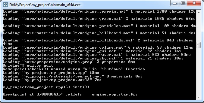

The console debugger window (in Windows):

When a breakpoint is encountered, the engine execution stops, and the application stops responding to user actions. Instead, the external console starts receiving user input.
In this console, you can step through instructions using the next command. Also it is possible to set the breakpoint during the debug process by using the break command. It is useful, for example, when you debug a loop. Or you can run the other debugger commands, if necessary.
If the console is unavailable, as in Windows release builds, this will seem as a hang-up of the engine. To avoid that, use a "breakpoint" macro defined in the file data/core/unigine.h. This macro also correctly preserves FPS values.
