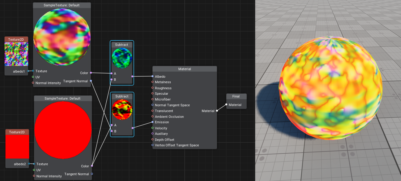

Example 1
Subtracting two textures (non-commutative). The upper Subtract node takes color values from the first Sample Texture node (first texture) and subtracts the values from the second Sample Texture node (second texture) from them providing Albedo values for the Material. While the lower Subtract node does vice versa subtracting values of the first texture from the values of the second one providing Emission values for the Material producing a nice looking effect.
