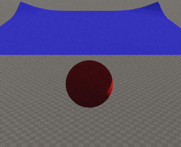

This example shows how to create a cloth pinned to two dummy bodies using the particles joints. The cloth falls down and rests on a sphere, which illustrates the cloth ability to change its form.
Falling cloth
To implement this, we need to perform the following:
  • Create a cloth and set its parameters.
  • Create two Dummy Objects that can hold the cloth. They also should have a body so that we can connect a cloth to them using joints.
  • Create a sphere that is not a physical body (so that it would not drop and roll away), but is a collider, so our cloth will not fall through.
We are going to create functions for each participant of the example and then use these functions in init() to create the required objects.
Creating a Cloth#
We create a plane that will represent a cloth — the Dynamic Mesh should be used to allow the cloth change at run time. Here we use the Primitives class to create a plane. You can also try to use your mesh instead, just make sure it complies with the triangulation requirements.
Then we assign the Cloth body to the created Dynamic Mesh and specify the required Cloth body parameters (mass, friction, restitution, etc) and the object parameters (transformation, color, name).

Using this function we create a cloth in the init() method.
Hanging the Cloth in the Air#
We need to fix one edge of the cloth in the air, otherwise it will unpredictably drop down, and there might be no contact with the sphere at all. This task is easily solved by using Dummy Object. We also assign the Dummy body to it, as joints may connect bodies only.

Using this function we create two points in the init() method and pin the cloth to them using the Particles joint:
// creating 2 dummy bodies to which the cloth will be attached
dummy1 = createBodyDummy("fixpoint1", vec3(1.0f, 1.0f, 1.0f), vec3(-10.0f, -10.0f, 25.0f));
dummy2 = createBodyDummy("fixpoint2", vec3(1.0f, 1.0f, 1.0f), vec3(-10.0f, 10.0f, 25.0f));
// creating 2 particles joints to attach the cloth to dummy bodies
JointParticles::create(dummy1->getBody(), cloth->getBody(), dummy1->getPosition(), vec3(1.0f));
JointParticles::create(dummy2->getBody(), cloth->getBody(), dummy2->getPosition(), vec3(1.0f));
Creating a Sphere#
A sphere is used as a prop to demonstrate how the cloth would cover it, thus there's no need to make it physical. We only need to enable collision for its surface, otherwise the cloth would pass through the sphere without any interaction.

Using this function we create a sphere in the init() method.
