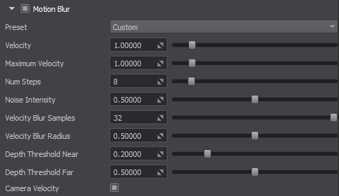

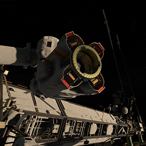

Motion Blur#
Motion Blur The value indicating if the motion blur effect is enabled. вкл. by default.
Console access: render_motion_blur (API control)
Preset The Motion Blur preset. To customize the Motion Blur effect options at run time you should activate the Custom preset: One of the following values:
  • Low (by default)
  • Medium
  • High
  • Ultra
  • Custom
Console access: render_motion_blur_preset (API control)
Customizable Settings#
Motion Blur custom settings
Motion Blur Settings
Velocity The scale value of bodies' linear and angular velocities used for the motion blur. The higher the value, the more blurred the objects will appear when moving. To use this option, rendering of the motion blur effect (see the MotionBlur) should be enabled.
Console access: render_motion_blur_velocity_scale (API control)
Maximum Velocity The maximum possible amount of motion blur for moving physical objects. When their body velocity exceeds the set value, they will be blurred as if they have the maximum velocity set by the parameter.
This parameter should be used:
  • To avoid excessive blurring of fast moving objects.
  • To save performance, as increasing the object's velocity leads increasing the radius of the motion blur effect that drops performance at too high values.
Console access: render_motion_blur_max_velocity (API control)
Num Steps The number of steps used in the motion blur. The higher the value, the more correct the motion blur effect is. At low values, moving objects may look doubled, however, performance will increase. To use this option, rendering of the motion blur effect (see the MotionBlur) should be enabled.
Range of values: [2, 64]. The default value is : 8.
Console access: render_motion_blur_num_steps (API control)
Noise Intensity The intensity of the noise used in the motion blur. To use this option, rendering of the motion blur effect (see the MotionBlur) should be enabled.
Console access: render_motion_blur_noise_intensity (API control)
Velocity Blur Samples The number of iterations performed to blur the border between moving and static objects. Higher values ensure a higher quality of blurring, but affect the performance. To use this option, rendering of the motion blur effect (see the MotionBlur) should be enabled.
Disabled in VR mode by default.
Range of values: [0, 512]. The default value is : 32.
Console access: render_motion_blur_velocity_blur_samples (API control)
Velocity Blur Radius The radius of the motion blur effect for the boundary between moving and static objects.
Range of values: [0.0f, inf]. The default value is : 0.5f.
Console access: render_motion_blur_velocity_blur_radius (API control)
Depth Threshold Near The value defining if the blur effect is applied to the foreground object. If the distance between the foreground object and the background object is less than this threshold value, the motion blur effect won't be applied to the foreground object. To use this option, rendering of the motion blur effect (see the MotionBlur) should be enabled.
Range of values: [0.0f, inf]. The default value is : 0.2f.
Console access: render_motion_blur_depth_threshold_near (API control)
Depth Threshold Far The value defining if the blur effect is applied to the background object. If the distance between the foreground object and the background object is less than this threshold value, the motion blur effect won't be applied to the background object. To use this option, rendering of the motion blur effect (see the MotionBlur) should be enabled.
Console access: render_motion_blur_depth_threshold_far (API control)
Camera Velocity The value indicating if camera velocity contributes to the motion blur effect (false to take into account velocities of objects only). To use this option, rendering of the motion blur effect (see the MotionBlur) should be enabled.
вкл. by default.
Console access: render_motion_blur_camera_velocity (API control)

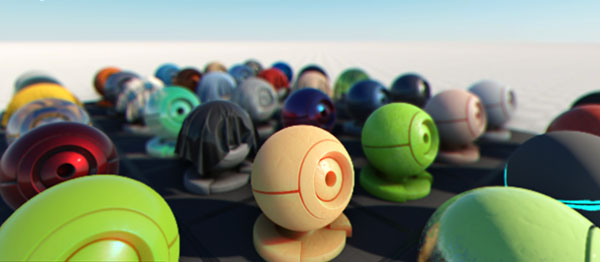

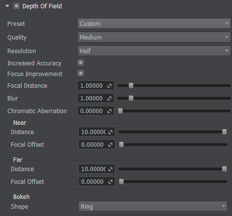

Depth Of Field#
Depth Of Field The value indicating if the DOF (Depth Of Field) effect is enabled. выкл. by default.
Console access: render_dof (API control)
Preset The DoF effect quality preset. To customize the DoF effect options at run time you should activate the Custom preset: One of the following values:
  • Very Low (by default)
  • Low
  • Medium
  • High
  • Ultra
  • Extreme
  • Custom
Console access: render_dof_preset (API control)
Presets override user-defined custom settings. When any preset other than Custom is active, modification of the parameters via API has no effect. The parameter value set via the last API call shall be used only when the Custom preset is active. When checking the current parameter value via API, you'll get the corresponding setting stored in the active preset (default or custom one).
Focal Distance The focal distance of the camera, i.e. a point where objects are in-focus and visible clearly.
Console access: render_dof_focal_distance (API control)
Blur The intensity of blur for the DOF (Depth Of Field) effect.
Console access: render_dof_blur (API control)
Chromatic Aberration The intensity of chromatic aberration for the DOF (Depth Of Field) effect.
Range of values: [0.0f, inf]. The default value is : 0.0f.
Console access: render_dof_chromatic_aberration (API control)

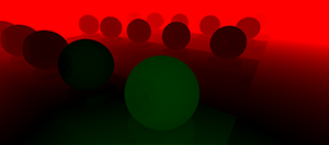

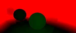

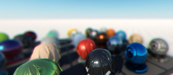

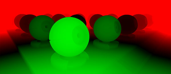

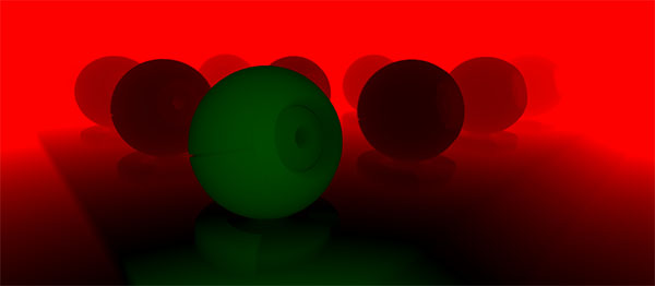

Near#
Distance The near DOF limit of the camera: the distance between the camera and the first element that is considered to be acceptably sharp. Black zone on the DOF mask means in-focus zone.
Range of values: [0.0f, inf]. The default value is : 10.0f.
Console access: render_dof_near_distance (API control)
Near Distance = 10
Near Distance = 10
Near Distance = 1.5
Near Distance = 1.5
The black zone on the DoF mask means in-focus zone.
Focal offset The offset from the focal to the nearest blurred zone. In other words, the distance when foreground (near) is in focus.
Console access: render_dof_near_focal_offset (API control)

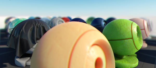

Far#
Distance The far DOF limit of the camera: the distance between the camera and the furthest element that is considered to be acceptably sharp. Black zone on the DOF mask means in-focus zone.
Console access: render_dof_far_distance (API control)
Far Distance = 10
Far Distance = 10
Far Distance = 1.5
Far Distance = 1.5
Focal offset The Sets the offset from the focal to the farthest blurred zone for the DOF effect. In other words, the distance when background (far) is in focus.
Console access: render_dof_far_focal_offset (API control)
Bokeh#
Shape The shape of the Bokeh for the DOF effect. This parameter determines the way the lens renders out-of-focus points of light.
For the DOF effect, the Bokeh effect is enabled by default.
  • ring (by default)
  • circle
Console access: render_dof_bokeh_mode (API control)
DOF custom settings
DOF Settings
Quality The quality of the DOF (Depth Of Field) effect. One of the following values:
  • Low - low quality
  • High - high quality
  • Ultra - ultra quality
Console access: render_dof_quality (API control)
Resolution The resolution of the DOF (Depth Of Field) effect. One of the following values:
  • quarter
  • half
  • full (by default)
Console access: render_dof_resolution (API control)
Increased Accuracy The value indicating if the increased accuracy option is enabled for the DOF (Depth Of Field) effect. When enabled, focusing calculation is performed with increased accuracy. выкл. by default.
Console access: render_dof_increased_accuracy (API control)
Focus Improvement The value indicating if the focus improvement option is enabled for the DOF (Depth Of Field) effect. When enabled, transitions between the focused and unfocused parts of the scene become more accurate. выкл. by default.
Console access: render_dof_focus_improvement (API control)

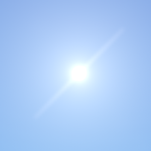

Glare Effects#
Threshold The brightness threshold, which is used to detect if an object should be blurred in the HDR mode. By the minimum value of 0, the bright areas can become overexposed.
Console access: render_camera_effects_threshold (API control)
Threshold = 0.6
Threshold = 1.2
Dirt Scale The intensity of lens dirt effect modulating the pattern of lens flares defined by the Dirt Texture. For example, it can be used to create an effect of unclean optics when the camera looks at the sun.
Console access: render_dirt_scale (API control)

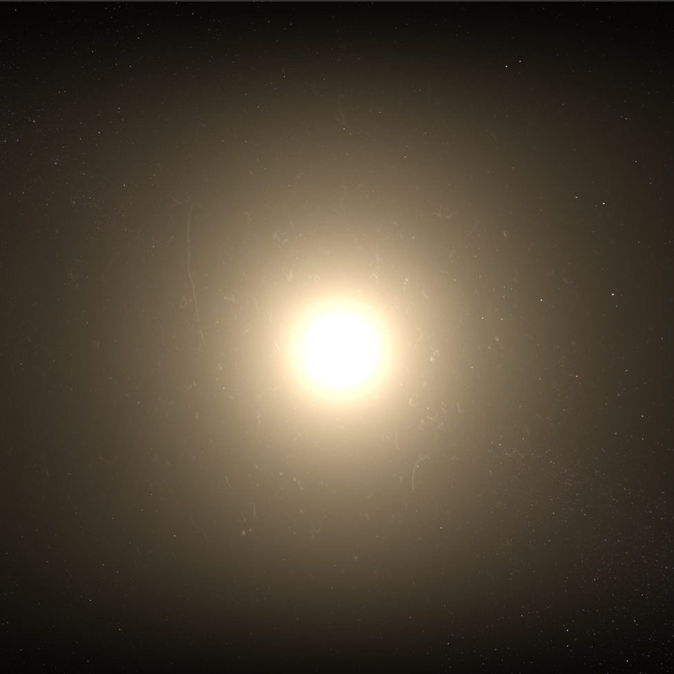

Dirt
A texture that creates an effect of dirty camera lens. For example, it can be used to create an effect of light reflections or unclean optics when the camera looks at the sun.
Example of dirt texture
No dirt texture
Custom dirt texture
If you can't see any effect of the Dirt texture, try tweaking the Threshold parameter.

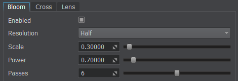

Bloom#
Bloom settings
Enabled The value indicating if the Bloom effect is enabled. выкл. by default.
Console access: render_bloom (API control)
Resolution The resolution of the Bloom effect. One of the following values:
  • quarter
  • half
  • full (by default)
Console access: render_bloom_resolution (API control)
Scale The scale of the Bloom effect.
Range of values: [0.0f, 1.0f]. The default value is : 0.3f.
Console access: render_bloom_scale (API control)
Power The power of the Bloom effect.
  • 0.0f (min) - the Bloom effect is blurred.
  • 1.0f (max) - the Bloom effect is more contrast.
Range of values: [0.0f, 1.0f]. The default value is : 0.7f.
Console access: render_bloom_power (API control)
Passes The number of passes for the bloom effect. During the pass a Bloom texture is generating. Up to 8 Bloom textures can be generated: each texture has lower resolution (original size, original size /2, original size /4, so forth) with Bloom effect. After that, all these Bloom textures with the different resolution form the final Bloom texture.
The higher the value, the smoother the effect is. However, this option significantly affects performance.
Range of values: [2, 8]. The default value is : 6.
Console access: render_bloom_passes (API control)

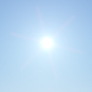

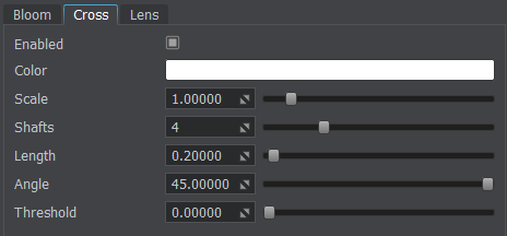

Cross#
Cross Settings
Enabled The value indicating if cross flares are enabled. выкл. by default.
Console access: render_cross (API control)
Color The color of the cross flares. To use this option, rendering of cross flares (see the Cross) should be enabled.
vec4_one - default value (white)
Console access: render_cross_color (API control)
Scale The color multiplier.cross color scale - a multiplier for the color of cross flares. Higher values produce more pronounced flares. To use this option, rendering of cross flares (see the Cross) should be enabled.
Console access: render_cross_scale (API control)
Scale = 0.4 (by default)
Scale = 0.7

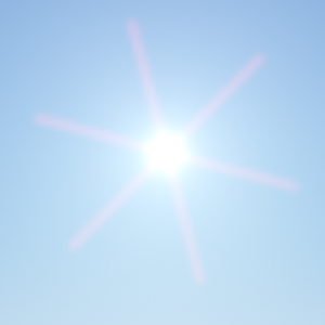

Shafts The number of shafts in a cross flare. High number of flares can cause a FPS drop on low-performance hardware. To use this option, rendering of cross flares (see the Cross) should be enabled.
Range of values: [2, 32]. The default value is : 4.
Console access: render_cross_shafts (API control)
Shafts = 2 (minimum)
Shafts = 6 (by default)
Shafts = 32 (maximum)
Length The length of a cross flare relative to the screen width. Increasing this value also leads to fading of the shafts across their length. To use this option, rendering of cross flares (see the Cross) should be enabled.
Range of values: [0.0f, 2.0f]. The default value is : 0.2f.
Console access: render_cross_length (API control)
Length = 0.2 (by default)
Length = 0.4
Angle The cross flares orientation angle. To use this option, rendering of cross flares (see the Cross) should be enabled.
Range of values: [-inf, inf]. The default value is : 45.0f.
Console access: render_cross_angle (API control)
Angle = 45 (by default)
Angle = 90
Threshold The brightness threshold for areas to produce flare. The higher the threshold value, the brighter the area should be to produce a flare. To use this option, rendering of cross flares (see the Cross) should be enabled.
Console access: render_cross_threshold (API control)

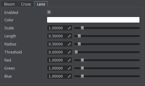

Lens#
Lens settings

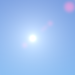

Enabled The value indicating if lens flares are enabled. выкл. by default.
Console access: render_lens (API control)
Color The color of HDR lens flares. To use this option, rendering of lens flares (see the Lens) should be enabled.
Console access: render_lens_color (API control)
Scale The multiplier for color (see the LensColor) of HDR lens flares. To use this option, rendering of lens flares (see the Lens) should be enabled.
Console access: render_lens_scale (API control)
Scale = 0.25
Scale = 0.5

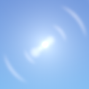

Length The length of the radial lens flare indicating if the whole radial lens flare is rendered on the screen or only a part of it. This option controls how lens flares pattern is distributed. To use this option, rendering of lens flares (see the Lens) should be enabled.
Console access: render_lens_length (API control)
Radius The radius of the spherical lens flares on the screen. 1.0f corresponds to a screen-wide radius (a lens flare is not visible). To use this option, rendering of lens flares (see the Lens) should be enabled.
Console access: render_lens_radius (API control)
Radius = 0.07
Radius = 0.1
Threshold The value of the brightness threshold for areas to produce lens flares. The higher the threshold value, the brighter the area should be to produce flares. To use this option, rendering of lens flares (see the Lens) should be enabled.
Console access: render_lens_threshold (API control)
Red
Color displacement for the red channel of lens flares.
Red = 0.9
Red = 1
Red = 1.1
Green
Color displacement for the green channel of lens flares.
Green = 0.9
Green = 1
Green = 1.1
Blue
Color displacement for the blue channel of lens flares.
Blue = 0.9
Blue = 1
Blue = 1.1

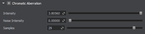

Chromatic Aberration#
Chromatic Aberration The value indicating if rendering of the Chromatic Aberration post-effect is enabled. This effect simulates color shifts in real-world camera lenses due to light rays entering a lens at different points causing separation of RGB colors. выкл. by default.
Console access: render_chromatic_aberration (API control)

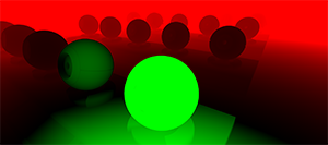

Intensity The intensity (strength) of the Chromatic Aberration post-effect. Controls how much color shifting occurs.
Console access: render_chromatic_aberration_intensity (API control)
Noise Intensity The intensity of noise applied for the Chromatic Aberration post-effect.
Console access: render_chromatic_aberration_noise_intensity (API control)
Samples The number of samples used for calculation of the Chromatic Aberration post-effect. Higher values reduce banding making the effect look smoother.
Range of values: [1, 32]. The default value is : 1.
Console access: render_chromatic_aberration_samples (API control)

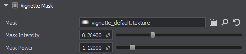

Vignette Mask#
Vignette Mask The value indicating if rendering of the Vignette Mask post-effect is enabled. The effect applies darkening towards the edges of an image compared to the center usually caused by thick or stacked filters, secondary lenses, and lens hoods. It can be used for an artistic effect, to draw focus to the center of the image. выкл. by default.
Console access: render_vignette_mask (API control)
Mask Custom texture to be used as a vignette mask.
Mask Intensity The intensity of the Vignette Mask. Defines the amount of vignetting on the screen: higher values moke the vignette wider.
Console access: render_vignette_mask_intensity (API control)
Mask Power The Power value that controls mask opacity for the Vignette Mask post-effect.
Console access: render_vignette_mask_power (API control)
