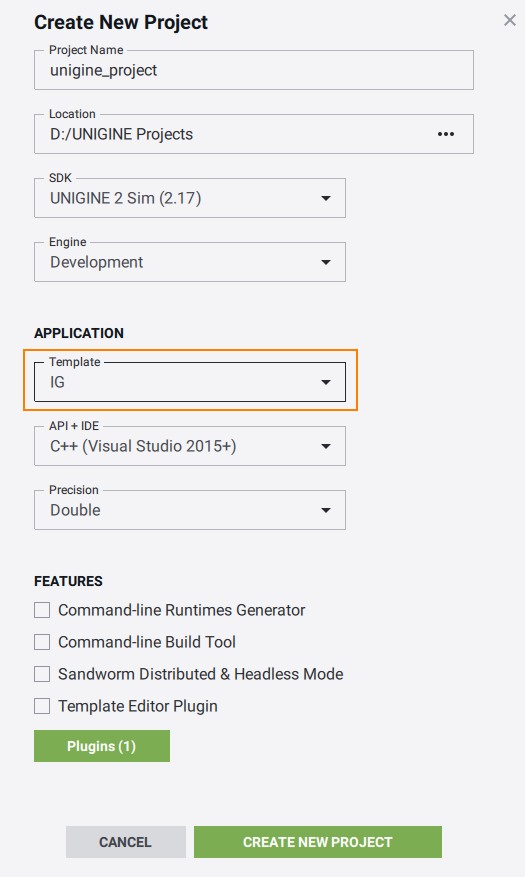

  1. Create a new project using the IG Template as described here.Создайте новый проект, используя IG Template и Компонентную систему С++ как описано здесь .
    Create a Project using the IG Template and Component System

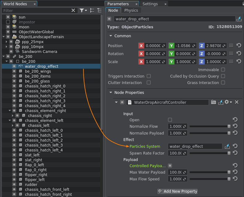

      	// Specifying the name of the property file and parameters for our component
      	PROP_NAME("WaterDropAircraftController");
      	PROP_PARAM(Toggle, open, false, "Open", "Input parameter for enabling/disabling the effect", "Input");
      	PROP_PARAM(Float, normalize_flow, 1.0f, "Normalize Flow", "Input parameter for the effect power normalization", "Input");
      	PROP_PARAM(Float, normalize_payload, 1.0f, "Normalize Payload", "Input parameter for payload normalization", "Input");
      	PROP_PARAM(Node, particles_system, "Particles System", "ObjectParticles with the effect", "Effect");
      	PROP_PARAM(Float, spawn_rate_factor, 100.0f, "Spawn Rate Factor", "Multiplier for spawn rate", "Effect");
      	PROP_PARAM(Toggle, controlled_payload_time, false, "Controlled Payload Time", "Enable: water effect can be stopped automatically", "Payload")
      	PROP_PARAM(Float, max_water_payload, 100.0f, "Max Water Payload", "Full water payload in units (weight or volume)", "Payload")
      	PROP_PARAM(Float, max_flow_speed, 1.0f, "Max Flow Speed", "Maximum water flow speed (units per second)", "Payload");

    In the header file (WaterDropAircraftController.h) define the name for the property file and describe parameters of the component: В заголовочном файле (WaterDropAircraftController.h) определите имя для файла свойств и опишите параметры компонента:
    Исходный код (C++)
    // WaterDropAircraftController.h

  5. Via the UNIGINE Editor, assign the new created property file (WaterDropAircraftController.prop) to a node, for which the component was created (Be-200 in our case).Через UnigineEditor назначьте новый созданный файл свойств (WaterDropAircraftController.prop) узлу, для которого был создан компонент (в нашем случае Be-200).
    Create a Particle System in the UNIGINE Editor and set its parameters as required. Add this Particle System to the corresponding field of the property.Создайте Систему частиц в UnigineEditor и задайте необходимые параметры. Добавьте эту систему частиц в соответствующее поле свойства.
