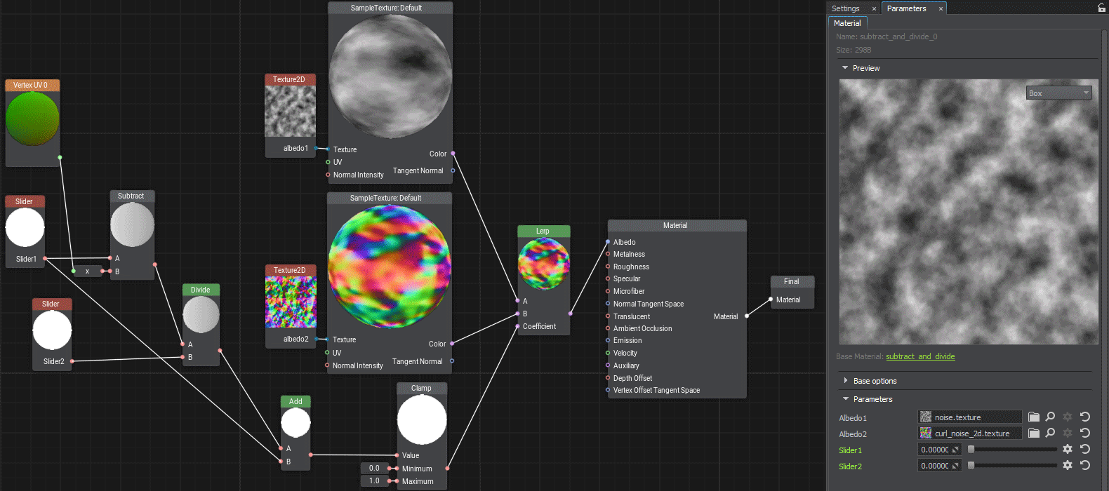

Gradient Mask
Gradient mask controlling interpolation (along U-axis) between two given textures, with Slider1 controlling the position of the transition and Slider2 controlling transition softness. Outputs of two Sample Texture nodes are connected to the Lerp node that performs linear interpolation between texture values with an interpolation coefficient. To get this coefficient we take U coordinate from the Vertex UV 0 node and subtract it from the current Slider1 value using the Subtract node, the result is then passed to the Divide node to be divided by the value of Slider2, then the result is summed up with Slider1 value and passed to the Clamp node to be restricted to the [0;1] range. The result of linear interpolation provides Albedo values for the Material.
