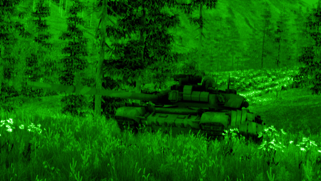

post_sensor_green
post_sensor_heat
Main Concepts#

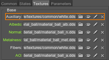

All objects that should be visible after applying the material should have a thermal map specified as the Auxiliary texture in the object's material.
Thermal map
In case of the post_sensor_green material, the auxiliary texture will be used as a glow texture.
The Auxiliary texture is a 3-channel texture (RGB). Each channel stores a temperature value in range [0;255]. In the post_sensor material, this range is represented as [0;1]. So, the white texture stores a temperature value in range [0;3].

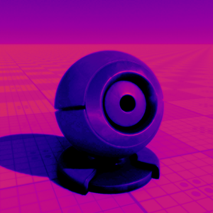

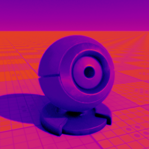

Ambient heat occlusion = -0.5
Ambient heat occlusion = 0.5

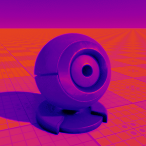

Influence scene power = 2; Influence scene scale = 0.5
Influence scene power = 4; Influence scene scale = 1.5

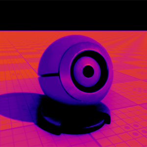

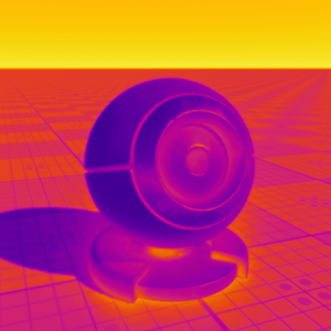

Global temperature = 0
Global temperature = 0.5
