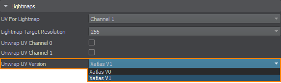

Migration of Lightmaps#
Some improvements in the previous release caused a bug in baked lightmaps of FBX models. To fix this bug, a new compatibility option named Unwrap UV Version has been added to FBX import settings. This option allows fixing lightmaps as follows:
  • If you've performed UV unwrapping and re-baked lightmaps in 2.19.1.2, select Xatlas V1.
  • If your lightmaps were last baked before 2.19.1.2, select Xatlas V0.
