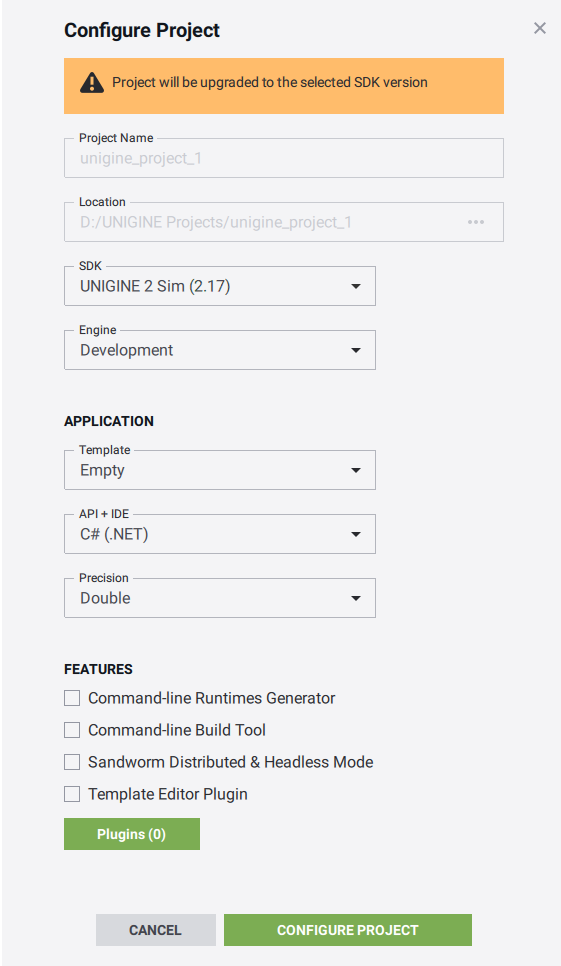

Projects that require upgrade are marked with the Upgrade label:
To upgrade your project to the newest installed version of UNIGINE SDK:
Click the Upgrade label on the project image or Other Actions -> Configure. The following form will open:
- Choose the newest installed version of the SDK and click CONFIGURE PROJECT.
- Specify a path to the backup folder into which the original project will be copied. Keep Migrate Content checked and click UPGRADE PROJECT.

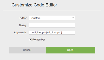

Customizing IDE Options#
To change a tool, do the following:
On Windows, click an ellipsis on the Open Code IDE button. The following form will open:
Choose Custom in the drop-down list and specify a path to a custom tool (e.g. IDE or editor) with required arguments:

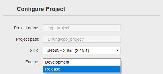

To reconfigure the project:
Click Other Actions -> Configure.
Select the Release option in the Engine drop-down.
- Click the Update Configuration button at the bottom of the configuration window to save the configuration.
As soon as the project has been reconfigured to the Release build, it can be run without SDK Browser — run the launch_release file in the project folder.

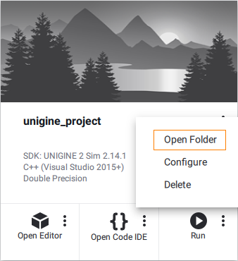

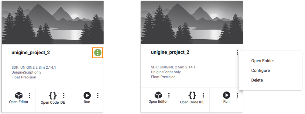

Other Actions#
When clicking the Other Actions button, the following options are available:
Configure | Change project settings. |
Open Folder | Open the project folder. |
Delete | Delete the project. |
Updating Project Configuration#
When clicking Other Actions -> Configure, the following form opens:
Via this form, you can change settings of an existing project: the UNIGINE Engine build used for the project, the version of the release application, the coordinates precision, and the general settings. This option should also be used when you need to upgrade the existing project to the newest SDK version.
Moreover, you can restore the project's files that were corrupted, missed, or mistakenly modified. For this, you should leave settings in the form unchanged and press the Update Configuration button. In this case, the following files of the project will be restored (they will be copied from the SDK):
