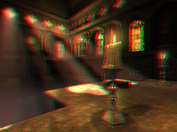

Anaglyph Mode#
Anaglyph stereo is viewed with red-cyan anaglyph glasses. See further details on rendering below.
To launch Anaglyph stereo mode:
  1. Specify the STEREO_ANAGLYPH definition on the start-up (together with other required CLI arguments).
  2. Run the 64-bit application (or its debugging version).
Shell commands
main_x64 -extern_define STEREO_ANAGLYPH
