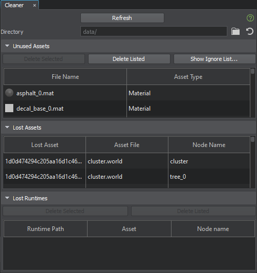

Cleaner checks each asset that your project contains and displays irregularly used assets.
To open the Cleaner window, choose Tools -> Cleaner on the Menu Bar of UnigineEditor.
The Cleaner window will open:

  1. Click Refresh to check the project for lost and unused assets.
    You can narrow the search scope by specifying a directory in the Directory field: Cleaner will display and manage the lost and unused assets from the specified directory only. To see results after setting (or resetting ) the directory, click Refresh once again.
    After analyzing assets in your project, Cleaner shows the following details.
  2. Manage unused assets using the buttons available on the Unused Assets tab.
    Use delete buttons carefully. Deleted assets cannot be restored.
  3. Click Refresh to update the list. Deleting unused assets can reduce the number of lost assets.
  4. Fix Lost Assets. Fixing of lost assets is possible only manually — by checking each asset displayed in the second or third column.
  5. Manage Lost Runtimes using the buttons available on the tab. The buttons are the same as for the Unused Assets.
    Use delete buttons carefully. Deleted files cannot be restored.
