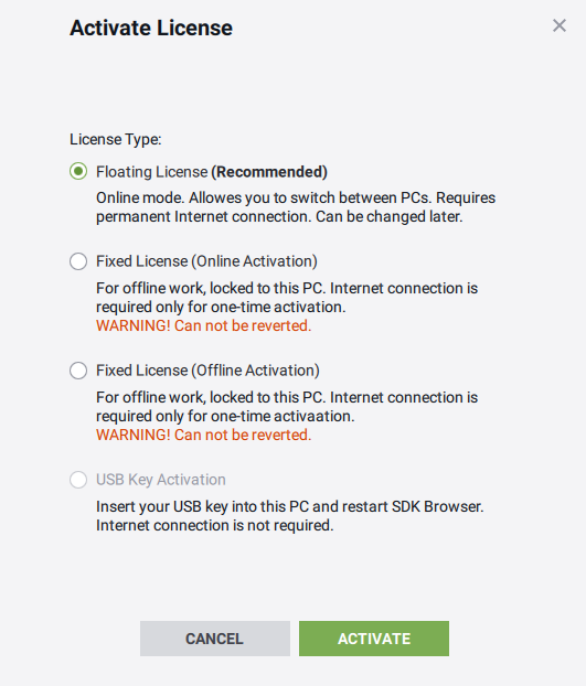

After you have installed an SDK, the Activate License window opens:安装 SDK 后,激活许可证窗口将打开:
License activation types are available depending on your license. If a certain license activation type is not available as supposed, contact the person who is assigned the role of Company Admin for assistance.许可证激活类型取决于您的许可证。如果某个许可证激活类型不可用,请与分配Company Admin角色的人员联系以寻求帮助。

To activate a product with this type of activation, select the Floating License type in the Activate License window that appears immediately after the product has been installed:要使用这种激活类型激活产品,请在安装产品后立即显示的Activate License窗口中选择Floating License类型:
If the product has already been installed, but is not activated, do the following:如果产品已安装,但未激活,请执行以下操作:
  1. Run SDK Browser and sign in with your credentials.运行SDK浏览器并使用您的凭据登录。
  2. Go to the Products tab of the SDK Browser.转到SDK BrowserProducts选项卡。
  3. Click Activate on the SDK panel.SDK面板上单击Activate
  4. In the window that opens, choose Floating License and click Activate. SDK will be activated and locked to the current account.在打开的窗口中,选择Floating License并单击Activate。SDK将被激活并锁定到当前帐户.
