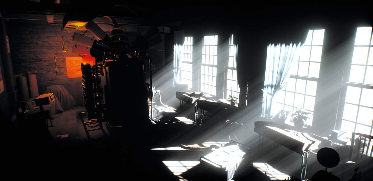

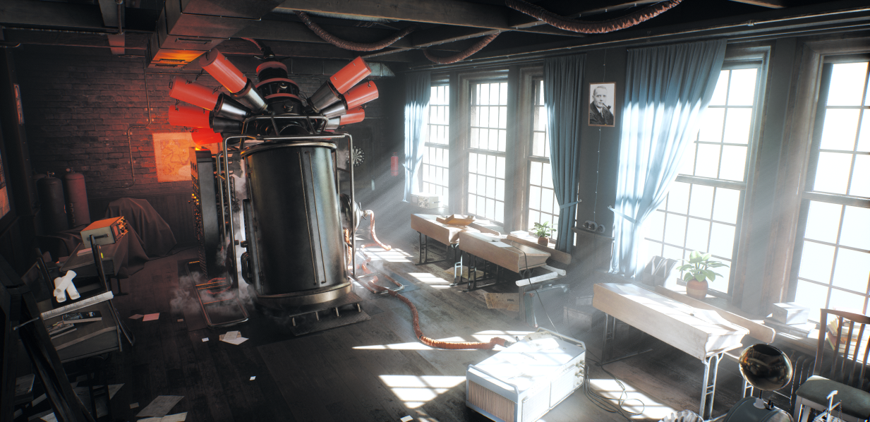

The following comparison shows the use of global illumination in a scene with two light sources: a red Omni Light and a World Light.下面的比较显示了在具有两个光源的场景中全局照明的使用:红色Omni LightWorld Light,其中包括体积太阳轴
The left image shows the scene illuminated with direct light only, so that we see only silhouettes of unlit objects and a large number of details is hidden in the darkness.左图仅显示了直接光照下的场景,因此我们只能看到未照明物体的轮廓,并且大量细节隐藏在黑暗中。
The right image shows the scene with both direct and indirect light, which makes it look way more realistic and consistent.右图显示的是直接和间接照明的场景,这使它看起来更加真实和一致。

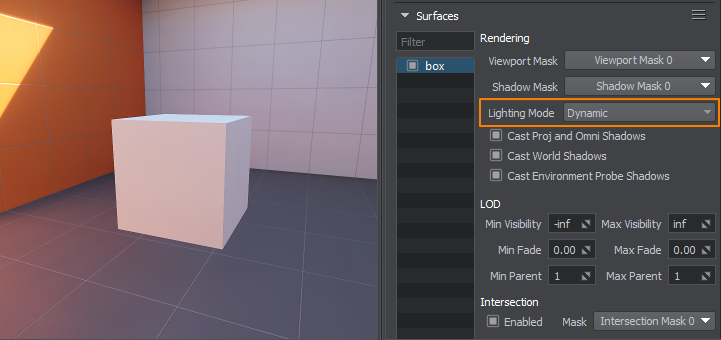

The following modes are available:Use the Lighting Mode parameter to define how a surface contributes to lighting. The following modes are available:可以使用以下模式:

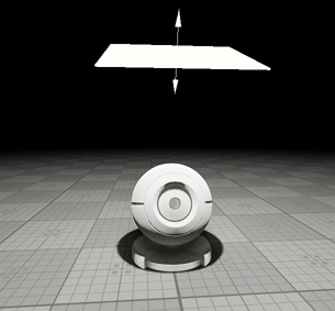

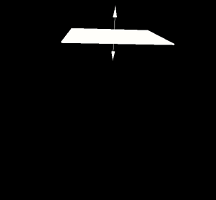

  • Dynamic. The light source provides direct realtime lighting only. It is considered disabled while light baking is being calculated, that is why the scene remains unlit when the light is turned off after light baking. No shadows are baked.
    Dynamic light source enabled. No GI is baked.Dynamic light source enabled. No GI is baked.
    Dynamic light source disabled.Dynamic light source disabled.
    Dynamic light source enabled. No GI is baked.Dynamic light source disabled.
    The Dynamic mode excludes the surface from use in static lighting and is suitable for dynamic shadows. Use this option for dynamic objects.
    The Advanced mode enables manual adjustment of all lighting-related settings:
    Dynamic. 光源仅提供直接的实时照明。 在计算光烘焙时,它被认为是禁用的,这就是为什么在光烘焙后关闭光源时场景保持不亮的原因。 没有阴影被烘烤。
    Dynamic light source enabled. No GI is baked.启用动态光源。没有GI被烘烤。
    Dynamic light source disabled.动态光源已禁用。

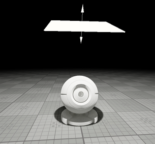

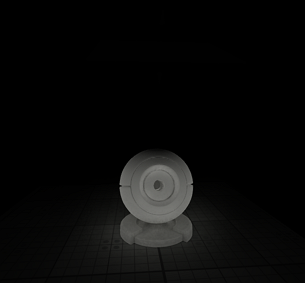

  • Static. The light source contributes to light baking and remains enabled all the time providing direct realtime lighting while the indirect light is being baked. When lighting is baked, such light sources are not to be moved and modified. Changing them can make lighting inconsistent and require re-baking. Shadows for Omni, Proj, and World lights are baked.
    Static light source enabled.Static light source enabled.
    Static light source disabled. Indirect light is baked into a Voxel Probe.Static light source disabled. Indirect light is baked into a Voxel Probe.
    Static light source enabled.Static light source disabled. Indirect light is baked into a Voxel Probe.

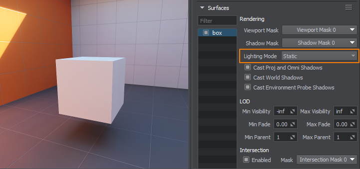

    The Static mode is optimized for use in static global illumination, reflections and shadows.
    Surfaces in the Static lighting mode block and reflect light when baking lighting to Voxel Probes and lightmaps, visible for static reflections provided by Environment Probes and cast cached shadows, lightmapping is available for them. This option is best suitable for immovable objects of static environment.
    Static. 光源有助于光的烘烤,并始终保持启用状态,从而在烘烤间接光时提供直接的实时照明。 烘烤照明时,请勿移动此类光源。 否则,此选项可能会导致眼睛记录的物理准确性不足。Omni, ProjWorld灯的阴影已烘烤
    Static light source enabled.启用了静态光源。
    Static light source disabled. Indirect light is baked into a Voxel Probe.静态光源已禁用。间接光被烘烤。

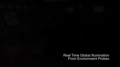

For scenes that have moving light sources and changing environment, baking of lighting is inappropriate. The following realtime approaches of GI simulation are provided in UNIGINE:对于具有不断变化的光源和变化的环境的场景,不宜使用照明。在UNIGINE中提供了以下GI模拟的实时方法。
  • Ambient lighting from dynamic environment probes.动态环境探针的环境照明。
