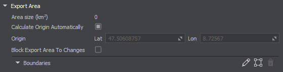

Parameters
参数#
Area Size Displays the size of the selected area in square kilometers.显示所选区域的大小平方公里。
Calculate Origin Automatically If enabled, the origin is calculated automatically based on the data provided. If Export Area is changed and the terrain is regenerated, the origin would be updated automatically.如果启用,将根据提供的数据自动计算原点。如果更改了Export Area并重新生成地形,则原点将自动更新。
Origin If Calculate Origin Automatically is disabled, the origin latitude and longitude can be edited here, and they will not be recalculated automatically if the Export Area is changed and the terrain is regenerated.如果禁用Calculate Origin Automatically,则可以在此处编辑原点纬度和经度,如果 导出区域已更改,地形已重新生成。
Block Export Area to Changes
If enabled, the selected Export Area cannot be modified. This option is useful, if you want to move around the map without occasionally shifting or modifying Export Area.如果启用,所选的Export Area不能被修改。如果您希望在不偶尔移动或修改Export Area的情况下移动映射,则此选项非常有用。
