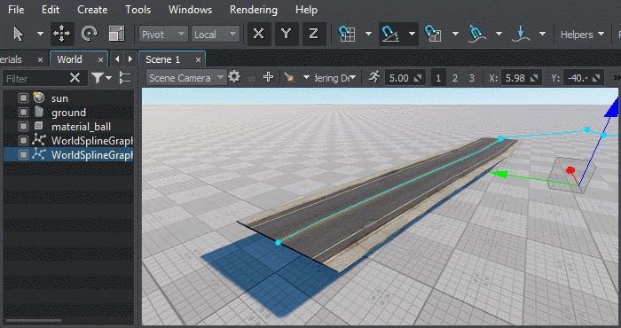

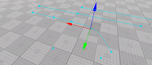

A spline graph is determined by a set of points p0, p1, ... pn and a set of edges or segments (cubic Bezier splines), that connect some or all of these points.样条图由一组点p0, p1, ... pn和一组连接某些或所有这些点的边或线段(三次贝塞尔曲线样条)确定。
Each segment is determined by a starting (pSTART) and an ending (pEND) point, as well as tangent vector coordinates at these points, which determine the curvature of the segment (tSTART and tEND respectively). Points, that are shared by more than two segments are called junctions.每个分段都由起点(pSTART)和终点(pEND)以及这些点处的切线矢量坐标确定,这些点确定分段的曲率(分别为tSTARTtEND)。由两个以上段共享的 点称为交界处
Source nodes (currently Static Mesh, Skinned Mesh, and Projected Decal) can be placed at points and along the segments of the spline graph. Each point and segment can have a single or a set of source nodes assigned. One of the following modes can be selected for each individual source node assigned to a segment:源节点(当前为Static Mesh, Skinned MeshProjected Decal)可以放置在样条图的点处或沿着样条图的线段放置。每个点和线段可以分配一个或一组源节点。可以为分配给段的每个单独的源节点选择以下模式之一:
    Stretching is available only for Static Mesh source nodes.Stretching is available only for Static Mesh source nodes.
    stretching-源节点沿样条线段拉伸。
    Stretching is available only for Static Mesh source nodes.拉伸仅适用于静态网格源节点。
  • tiling - source nodes are duplicated along the spline segment.tiling-源节点沿样条线段重复。
  • adaptive (a combination of the first two) - source nodes are duplicated along the spline segment, but the length of each node (stretching) is determined by the curvature of the corresponding part of the segment. Thus, long nodes are placed along the straight parts of segments, while short ones - along the curved parts, providing a reasonable balance between the plausible look and performance.adaptive(前两个的组合)-沿样条线段复制源节点,但是每个节点的长度(拉伸)由段的相应部分的曲率确定。因此,长节沿线段的笔直部分放置,而短节沿弯线部分放置,在合理的外观和性能之间提供合理的平衡。
For example, a segment can have two source nodes assigned: one representing the road (stretched) and another for roadway lights (tiled with a gap). 例如,一个路段可以分配两个源节点:一个代表道路(拉伸),另一个代表道路灯(与道路平铺)。差距)。

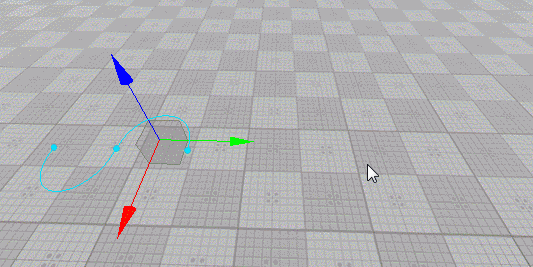

Coordinates of the UP vector are additionally stored for each point of the segment. This vector is used to define orientation of nodes placed along the segments of the spline graph. By default this vector is parallel to the Z axis. The UP vector does not affect the curvature of the spline segment itself.UP矢量的坐标还针对该段的每个点存储。该向量用于定义沿着样条图的线段放置的节点的方向。默认情况下,此向量平行于Z轴。 UP向量不会影响样条曲线段本身的曲率。
UP vector adjustment.向上矢量调整。

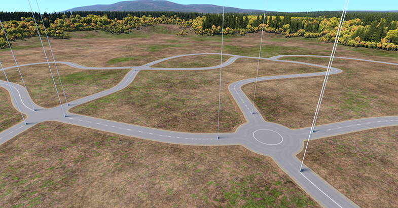

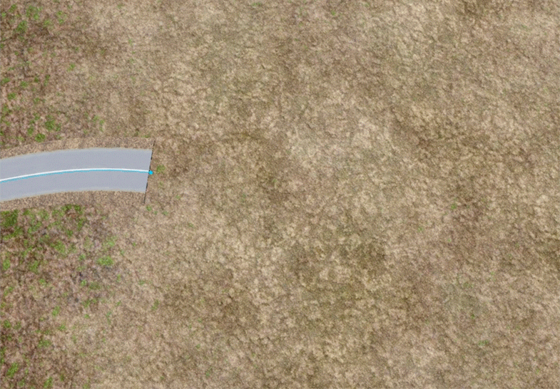

    • world_spline_graph/roads - roads created on the terrain surfaceworld_spline_graph/roads - roads created on the terrain surface

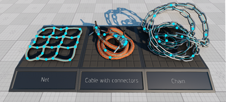

    • world_spline_graph/ropes - ropes, chains, and cablesworld_spline_graph/ropes - ropes, chains, and cables
    world_spline_graph/roads - roads created on the terrain surfaceworld_spline_graph/ropes - ropes, chains, and cables
    样本说明WorldSplineGraph的用例Samples套件中包含的节点:
    • world_spline_graph/roads - roads created on the terrain surfaceworld_spline_graph/roads-在地形表面上创建的道路
    • world_spline_graph/ropes - ropes, chains, and cablesworld_spline_graph/ropes-绳索,链条和电缆

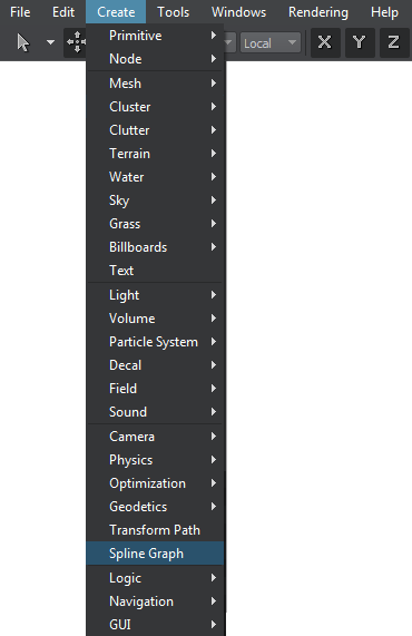

To create a new World Spline Graph, do the following:要创建一个新的World Spline Graph,请执行以下操作:
    添加一个World Spline Graph节点:在菜单栏, 选择Create -> Spline Graph

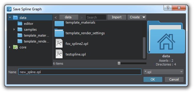

  2. Specify a name of existing spline file (*.spl) to be used for the new World Spline Graph or a new name to create your spline from scratch.
    Remember, *.world files store only WorldSplineGraph node's data (transformation, list of source nodes, etc.), while spline graphs themselves are stored in separate *.spl files. To save the spline graph that you created in the world, click Save Spline in the Parameters tab and specify a file name for it. Remember, *.world files store only WorldSplineGraph node's data (transformation, list of source nodes, etc.), while spline graphs themselves are stored in separate *.spl files. To save the spline graph that you created in the world, click Save Spline in the Parameters tab and specify a file name for it.
    指定要用于新样条文件的现有样条文件(*.spl)的名称World Spline Graph或使用新名称从头开始创建样条线。
    Remember, *.world files store only WorldSplineGraph node's data (transformation, list of source nodes, etc.), while spline graphs themselves are stored in separate *.spl files. To save the spline graph that you created in the world, click Save Spline in the Parameters tab and specify a file name for it. 请记住,*.world文件仅存储WorldSplineGraph节点的数据(转换,源节点列表等),而样条图本身存储在单独的*.spl文件中。要保存在世界上创建的样条图,请在Parameters选项卡中单击Save Spline并为其指定文件名。

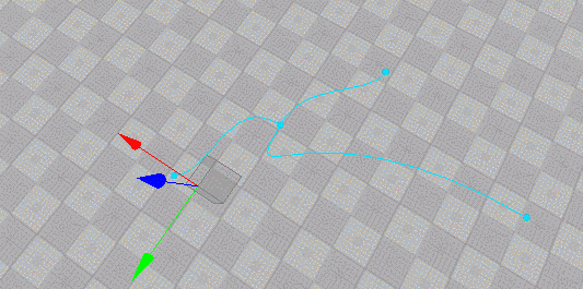

Adjusting Point's Tangent
调整点的切线#

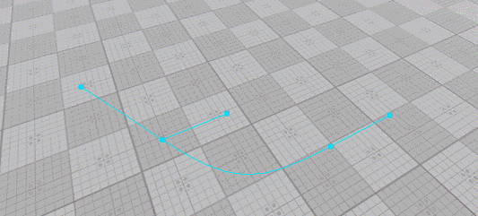

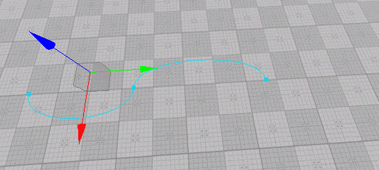

Tangents control the curvature of the spline segment. To adjust tangent at a point do the following:切线控制样条线段的曲率。要调整一点的切线,请执行以下操作:
  1. Select the World Spline Graph.选择World Spline Graph
  2. Select the desired point (Move manipulator will appear).选择所需的点(将出现“移动操纵器”)。
  3. Select the desired tangent (in case the selected point is shared by multiple segments, several tangents will be displayed for it). As you select a tangent the Move manipulator appears next to it.选择所需的切线(如果所选点被多个线段共享,则将为其显示多个切线)。选择切线时,其旁边将显示“移动”操纵器。
  4. Use the Move manipulator as you would do to move a node (the form of the corresponding segment will change).使用移动操纵器,就像移动节点一样(相应段的形式将改变)。

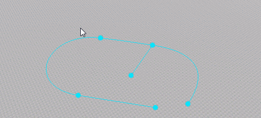

Sometimes it might be necessary to merge certain points (e.g. to close a spline). To merge two or more points into one do the following:有时可能需要合并某些点(例如,关闭样条线)。要将两个或多个点合并为一个,请执行以下操作:
  2. Select points you want to merge with a region selection tool or one-by-one while holding the Shift key pressed.按住Shift键,选择要与区域选择工具合并的点或一对一地选择点。
  3. Right-click on a point you want to merge selected ones into and choose Merge To This Point.右键单击要合并所选点的点,然后选择Merge To This Point
  4. All points will be merged into one shared by the segments, to which the merged points belonged.所有点将合并为合并的点所属的线段共享的一个。

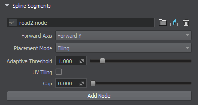

For each of the source nodes assigned to the selected segment(s) the following settings are available for adjustment via the Parameters tab:对于分配给所选段的每个源节点,以下设置可通过Parameters选项卡进行调整:
Node Path to a *.node file containing a source node.包含源节点的*.node文件的路径。
Forward Axis Defines which axis of the source node is to be oriented along the spline.定义将沿样条线定向源节点的哪条轴。
    This mode is the most performance-friendly.This mode is the most performance-friendly.
    Stretch - a single source node instance is stretched along the segment.
  • Tiling - multiple instances of the source node are placed along the segment. The number of instances is determined by the sizes of the segment and the source node and the value of the Gap parameter.Tiling - multiple instances of the source node are placed along the segment. The number of instances is determined by the sizes of the segment and the source node and the value of the Gap parameter.
  • Adaptive - a combination of the previous two resulting in multiple instances of the source node placed along the segment. Some of these instances may be stretched depending on segment's curvature.Adaptive - a combination of the previous two resulting in multiple instances of the source node placed along the segment. Some of these instances may be stretched depending on segment's curvature.
This mode is the most performance-friendly.Tiling - multiple instances of the source node are placed along the segment. The number of instances is determined by the sizes of the segment and the source node and the value of the Gap parameter.Adaptive - a combination of the previous two resulting in multiple instances of the source node placed along the segment. Some of these instances may be stretched depending on segment's curvature.
要生成的对象的类型。以下之一:
    Stretch-沿该段拉伸单个源节点实例。
    This mode is the most performance-friendly.此模式是最性能友好的。
  • Tiling - multiple instances of the source node are placed along the segment. The number of instances is determined by the sizes of the segment and the source node and the value of the Gap parameter.Tiling-源节点的多个实例沿线段放置。实例数由段和源节点的大小以及Gap参数的值确定。
  • Adaptive - a combination of the previous two resulting in multiple instances of the source node placed along the segment. Some of these instances may be stretched depending on segment's curvature.Adaptive-前两个的组合,导致沿该段放置源节点的多个实例。这些实例中的某些实例可能会根据线段的曲率进行拉伸。
Available for Adaptive placement mode only.Available for Adaptive placement mode only.
确定在Adaptive放置模式下可以将源节点的实例拉伸多少,以覆盖该段的整个长度。
Available for Adaptive placement mode only.仅适用于Adaptive放置模式。
UV Tiling Enables tiling of the source node's textures.启用源节点纹理的平铺.
Available for Tiling placement mode only.Available for Tiling placement mode only.
Tiling放置模式定义源节点上相邻实例之间的间隔(以单位为单位)。
Available for Tiling placement mode only.仅适用于Tiling放置模式。

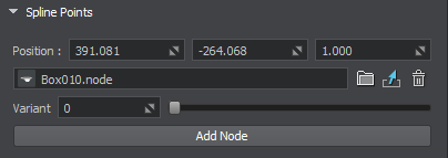

To assign a source node to selected point(s) do the following:要将源节点分配给选定的点,请执行以下操作:
  • Select the desired point(s).选择所需的点。
  • Click Add Node in the Parameters tab.Parameters选项卡中单击Add Node

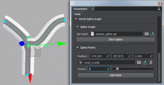

    For a junction point to behave properly an ObjectMeshSkinned node should be assigned, and the number of its bones should correspond to the number of spline segments connected to this point.For a junction point to behave properly an ObjectMeshSkinned node should be assigned, and the number of its bones should correspond to the number of spline segments connected to this point.
    在打开的窗口中,选择所需的节点,然后单击OK
    For a junction point to behave properly an ObjectMeshSkinned node should be assigned, and the number of its bones should correspond to the number of spline segments connected to this point.为一个交界处为使点正常运行,应分配一个ObjectMeshSkinned节点,其骨骼的数量应与连接到该点的样条线段的数量相对应。
For each of the source nodes assigned to the selected point(s) the following settings are available for adjustment via the Parameters tab:对于分配给选定点的每个源节点,以下设置可通过Parameters选项卡进行调整:
This parameter affects only the source nodes representing junctions (ObjectMeshSkinned).This parameter affects only the source nodes representing junctions (ObjectMeshSkinned).
有许多可能的变体交界处。使用此滑块可以选择最合适的一个。
This parameter affects only the source nodes representing junctions (ObjectMeshSkinned).此参数仅影响表示结点(ObjectMeshSkinned)的源节点。

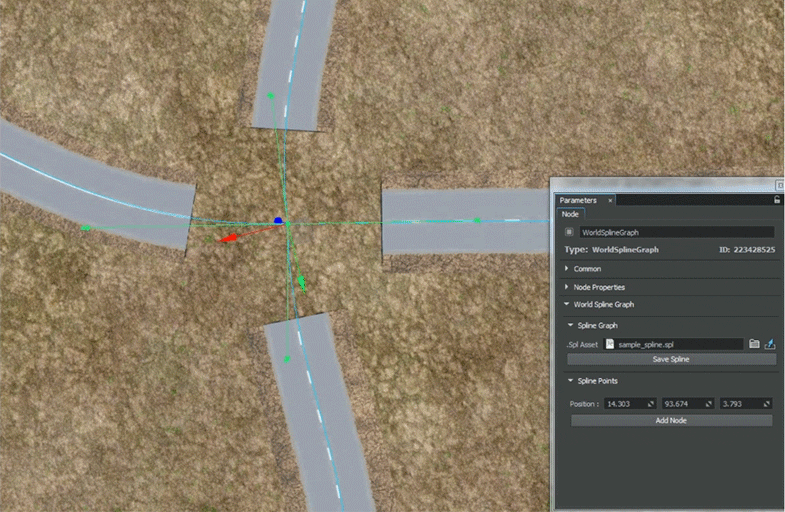

Junctions
交界处#
Junctions should interact with all entering segments properly providing seamless transitions. For this puprose ObjectMeshSkinned source nodes are used.交界处应与所有进入的路段正确互动,以提供无缝过渡。为此,使用了ObjectMeshSkinned个源节点。
Source nodes to be used for junctions must comply with the following requirements:用于结点的源节点必须符合以下要求:
  • Joints of a junction in the UnigineEditor must have their Y axes oriented from the center of the junction to the edges of the corresponding branches.UnigineEditor中接合点的关节必须使其Y轴从接合点中心到相应分支的边缘。
  • Outer joint of each junction’s branch must be placed exactly at the center of its outer edge, weights for outer vertices of the branch must be maximal for the outer joint (i.e., outer vertices of the branch are affected only by the outer joint).每个结点的分支的外部关节必须正好位于其外部边缘的中心,分支的外部顶点的权重必须对于外部关节最大(即,分支的外部顶点仅受外部关节影响)。
  • As junction and segment are represented by separate meshes, textures and their UV maps must ensure seamless junction-segment and segment-segment transitions.由于接合点和线段由单独的网格表示,因此纹理及其UV贴图必须确保无缝的接合线段和线段段过渡。
  • A segment may have junctions at both of its endpoints, Therefore the texture used for the segment must be symmetrical, at least its edges.一个段的两个端点可能都具有连接点,因此用于该段的纹理必须对称,至少其边缘必须对称。
    • A junction as well as a road segment must be represented by a pair of meshes (embankment and the road itself). Embankment mesh is used for smooth blending with terrain surface. Just enable the Terrain Lerp state for the material assigned to embankment.A junction as well as a road segment must be represented by a pair of meshes (embankment and the road itself). Embankment mesh is used for smooth blending with terrain surface. Just enable the Terrain Lerp state for the material assigned to embankment.
    • To ensure correct deformation of segments and junctions triangulation for the road and embankment must match. This prevents penetration of meshes into each other when moving spline points up and down.To ensure correct deformation of segments and junctions triangulation for the road and embankment must match. This prevents penetration of meshes into each other when moving spline points up and down.
    A junction as well as a road segment must be represented by a pair of meshes (embankment and the road itself). Embankment mesh is used for smooth blending with terrain surface. Just enable the Terrain Lerp state for the material assigned to embankment.To ensure correct deformation of segments and junctions triangulation for the road and embankment must match. This prevents penetration of meshes into each other when moving spline points up and down.
    道路的特定要求:
    • A junction as well as a road segment must be represented by a pair of meshes (embankment and the road itself). Embankment mesh is used for smooth blending with terrain surface. Just enable the Terrain Lerp state for the material assigned to embankment.路口和路段必须用一对网格(路堤和道路本身)表示。路堤网格用于与地形表面平滑融合。只需为分配给路堤的物料启用Terrain Lerp状态即可。
    • To ensure correct deformation of segments and junctions triangulation for the road and embankment must match. This prevents penetration of meshes into each other when moving spline points up and down.为了确保路段和路口的正确变形,道路和路堤的三角剖分必须匹配。这样可以防止在上下移动样条线时使网格相互渗透。
Exporting World Spline Graph
导出世界样条图#
World Spline Graph works well as a tool for object placement and deformation, but due to some technical issues, it is difficult to use it in final applications as the resulting object. Therefore, as soon as the object arrangement is final, it is required to export the spline graph to the .mesh or .fbx file.World Spline Graph 作为对象放置和变形的工具效果很好,但是由于一些技术问题,很难在最终应用程序中将其用作生成的对象。因此,一旦对象排列完成,就需要将样条图导出到 .mesh.fbx 文件。
To export World Spline Graph, right-click it in the World Nodes hierarchy, select Export to and a preferable option:要导出 World Spline Graph,请在 World Nodes 层次结构中右键单击它,选择 Export to 和一个更可取的选项:
World Spline Graph Export
The export operation produces unique geometry that you can use in your projects like any other model without any additional restrictions.导出操作会生成独特的几何图形,您可以像使用任何其他模型一样在项目中使用这些几何图形,而不受任何额外限制。
