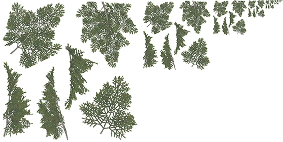

Mipmap Type
Type of filtering to be used for mipmap generation. Available options are:用于生成Mipmap的过滤类型。可用的选项有:
  • Box — choose this type to use simple box filter for mipmap generation.Box:选择此类型可使用简单的框式过滤器生成mipmap。
    If a texture contains very narrow features (e.g., lines), then aliasing artifacts may be very pronounced. In this case it might be better to choose the Combined option.如果纹理包含非常狭窄的特征(例如线条),则混叠伪影可能会非常明显。在这种情况下,最好选择Combined选项。
  • Point — choose this type to use point filtration for mipmap generation.Point:选择此类型可将点过滤用于生成mipmap。
  • Combine — choose this type to get mipmaps from the source image.Combined: 选择此类型以从源图像获取多点映射。
    If the width and/or height of the source image are not power of 2, set the corresponding resolution parameter to Original.如果源图像的宽度和/或高度不是2的幂,则设置对应的分辨率参数Original
  • Sharpen — sharpness is applied for generated mipmaps. To configure the extent of sharpness, the following parameters are available:Sharpen:锐化应用于生成的mipmap。要配置清晰度的程度,可以使用以下参数:
    • Sharpness Intensity — intensity of the sharpness effect.Sharpness Intensity:锐度效果的强度。
    • Sharpness Radius — radius to which the effect is applied, with sub-texel accuracy.Sharpness Radius:应用效果的半径,具有子纹理精度。
    • Sharp Only Lightness — only the HSL lightness value is affected by the sharpness effect.Sharp Only Lightness:只有HSL亮度(lightness)值受锐利效果的影响。
