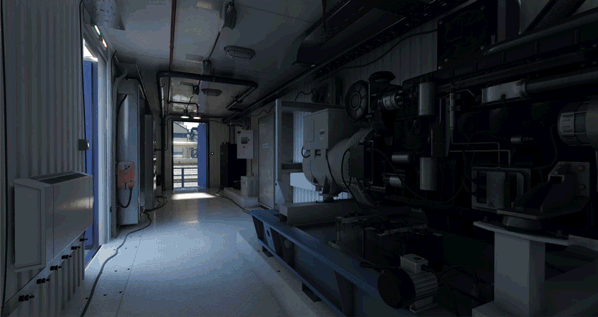

环境照明#
The primary application of Voxel Probes is ambient lighting. When baked, a Voxel Probes illuminates everything within its volume with ambient lighting providing a decent simulation of global illumination including ambient occlusion, light bounces and diffuse interreflections.Voxel Probes的主要应用是环境照明。烘焙后,Voxel Probes用环境照明照亮了其体积中的所有物体,从而提供了对整体照明的不错​​模拟,包括环境光遮挡,光反射和漫反射。

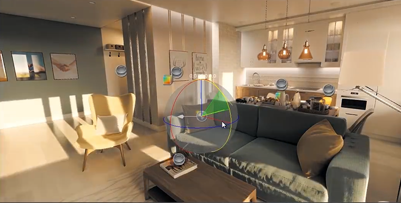

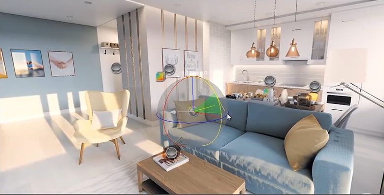

Diffuse Reflections
漫反射#
As each voxel of a Voxel Probe stores light data, a Voxel Probe is capable of providing diffuse (blurred) reflections at every spatial point within its volume provided Bake Internal Volume was enabled for baking. Control reflections by adjusting the Reflections Parameters.Voxel Probe的每个体素存储光数据时,如果启用了Bake Internal Volume进行烘焙,则Voxel Probe能够在每个空间点提供其体积的漫反射(模糊)反射。 通过调整反射参数控制反射。
Diffuse reflections provided by a voxel probe.体素探针提供的漫反射。

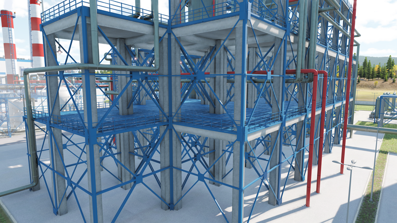

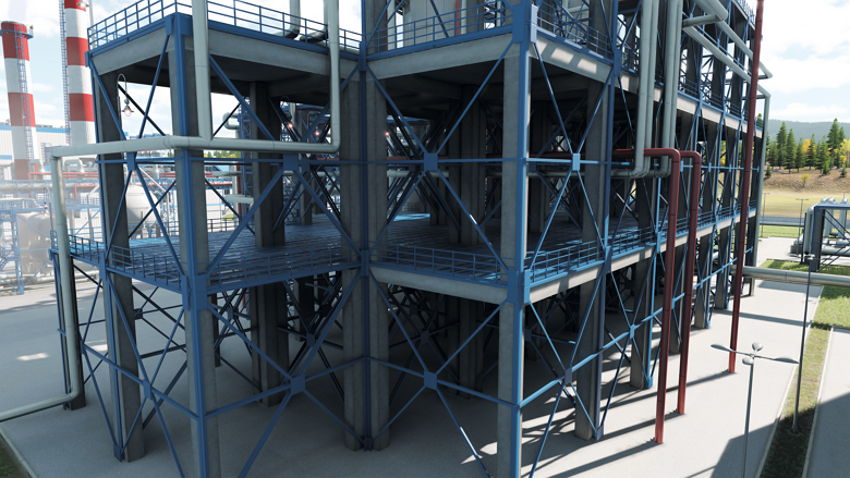

Additive Blending
添加剂混合#
More flexibility in lighting control is available with the Additive Blending mode. You can use it to blend lighting of several voxel probes together and control them separately (e.g. make a separate Voxel Probe for an indoor emissive light source and blend it with another Voxel Probes with lighting baked from the sky, having the ability to enable and disable them separately).Additive Blending模式可提供更大的照明控制灵活性。您可以使用它来混合几个体素探测器的照明并分别控制它们(例如,为室内发射光源制作一个单独的Voxel Probe并将其与另一个从天空烘烤的Voxel Probes进行混合,并具有分别启用和禁用它们的能力)。
Additive blending of two Voxel Probes.两个Voxel探针的添加混合。
