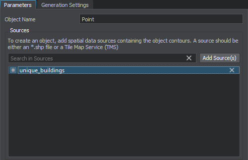

Sandworm allows placing objects on the generated terrain according to the georeferenced data, such as:Sandworm允许根据地理引用数据在生成的地形上放置对象,例如:

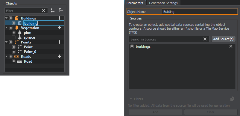

Object names may be set and changed as necessary either in the Sources or in the Parameters window. This name is also used for the generated objects in the World Nodes hierarchy window.可以在SourcesParameters窗口中根据需要设置和更改对象名称。这个名称也用于World Nodes层次结构窗口中生成的对象。
编辑对象名称

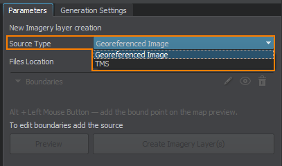

Sandworm works with both offline and online data sources:Sandworm可用于离线和在线数据源:
If you don't want to generate an added source, you can either delete or disable it in the Sources list.如果您不想产生额外的来源,您可以删除或禁用它在Sources列表中。
Georeferenced Image Source
地理照片来源#
Georeferenced Images are the data files already available on a PC:Georeferenced Images是PC上已经可用的数据文件:
  • Assets — files that are added to the file system and represent a part of the project. Depending on the size of assets, they can be stored in the /data directory or added as a mount. This approach is recommended for teamwork.Assets 是添加到 文件系统 并代表项目一部分的文件。 根据资源的大小,它们可以存储在 /data 目录或添加为 安装。 建议将此方法用于团队合作。
    We recommend importing image files as Unchanged, in order to avoid creating the unnecessary runtime files.我们建议以Unchanged的形式导入照片文件,以避免创建不必要的运行时文件。
  • External Files — files stored on the PC that are not a part of the file system. This type of data source may be helpful if the file extension is unknown to the file system. However, keep in mind that if you share this project, the path to the external file has to be updated accordingly.External Files 是文件存储在电脑上不是一个文件系统的一部分。这种类型的数据源可能是有用的,如果文件扩展名是未知的文件系统。然而,请记住,如果您分享这个项目,外部文件的路径必须相应更新。
File location — path to the file or group of files to be added. Multiple selection allows adding a number of files simultaneously and adds them as separate layers.文件位置是要添加的文件或文件组的路径。多重选择允许同时添加多个文件,并将它们作为单独的层添加。

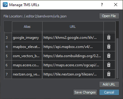

Adding Custom URLs添加自定义url
To add a URL, select the Add URL line in the drop-down window or click the image on the right:添加一个网址,选择Add URL行下拉窗口或点击右边的形象:
The following window will open to manage URLs:将打开以下窗口来管理url:
Requirements to TMS URLs:Requirements to TMS URLs:
A link to a Tile Map Service inserted as the URL should have x, y, and z embraced into curly brackets ({}).作为URL插入到图块地图服务的链接应该有x, yz包含在花括号({})中。
For example:例如:
  • The link to the OpenStreetMap tile map service (http://a.tile.openstreetmap.org/z/x/y.png) should be used as follows:OpenStreetMap 地图服务的链接(http://a.tile.openstreetmap.org/z/x/y.png)应该这样使用:
    http://a.tile.openstreetmap.org/{z}/{x}/{y}.pnghttp://a.tile.openstreetmap.org/{z}/{x}/{y}.png
  • The link to ArcGIS Online data (https://server.arcgisonline.com/ArcGIS/rest/services/World_Topo_Map/MapServer/tile/z/y/x.png) should be used as follows:链接到ArcGIS Online数据(https://server.arcgisonline.com/ArcGIS/rest/services/World_Topo_Map/MapServer/tile/z/y/x.png)应该这样使用:
    https://server.arcgisonline.com/ArcGIS/rest/services/World_Topo_Map/MapServer/tile/{z}/{y}/{x}.pnghttps://server.arcgisonline.com/ArcGIS/rest/services/World_Topo_Map/MapServer/tile/{z}/{y}/{x}.png
For sources that require tokens, the link should be arranged in the following way:为需要标记的来源,应安排在以下的方式:
https://api.mapbox.com/v4/mapbox.terrain-rgb/{z}/{x}/{y}.pngraw?access_token=your_tokenhttps://api.mapbox.com/v4/mapbox.terrain-rgb/{z}/{x}/{y}.pngraw?access_token=your_token
The sources that require login and password input are currently not supported.目前不支持需要登录和密码输入的源代码。

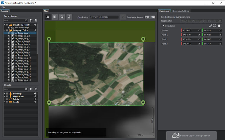

Boundaries define the scope of the source source data that is used for generation. By default, all data of a source are used for generation. That means if you don't set the boundaries for a Georeferenced Image, all data available in it will be used for generation.边界定义源数据来源的范围,是用来发电的。默认情况下,所有的数据来源用于一代。这意味着如果您不设置为Georeferenced Image边界,所有数据将用于生成。
A TMS source won't be created without setting the boundaries.如果不设置边界,就不会创建TMS源。
Boundaries are marked green with points as the corners:边界标记绿色与角点:
You can set points manually or enclose the area visible in the Map view and move the points, if necessary, using the following tools:您可以手动设置点或附上中可见的区域Map视图和移动的点,如果有必要,使用以下工具:
编辑边界按钮
Modifying boundaries: click and drag the point on the preview map or change its coordinates on the Parameters panel.修改边界:点击并拖动预览地图上的点或在Parameters面板上更改其坐标。
Adding points: hold ALT and click the left mouse button in the Map window.添加点:持有ALT并单击鼠标左键在Map窗口中。
Deleting points and boundaries: right-click on a single point in the Map window and click Remove in the context menu. You can also select a point in the Map window and press Delete on the keyboard.删除点和边界:右键单击Map窗口中的单个点,然后单击上下文菜单中的Remove。您还可以在Map窗口中选择一个点,然后按下键盘上的Delete

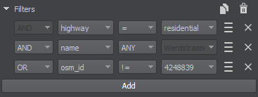

The Filter is a set of rules created using the Attributes.Filter是使用属性创建的一组规则。
Binary operation
Binary Operators
Binary operators AND and OR that allow combining several filters.二元操作符ANDOR相结合,允许多个过滤器。
Attribute name Name of the attribute available in the attribute table.属性的属性表的名称。
Attribute condition
Attribute Conditions
The available conditions are: =, !=, >, <, ANY. ANY generates all the objects that have any value assigned for the selected Attribute.可用的条件为:=, !=, >, <, ANYANY生成为所选Attribute分配了任意值的所有对象。
警告
When using > and <, make sure that the selected Attribute value type is a number. String comparison may cause issues.当使用 > 和<,确保选择的属性值类型是一个数字。 字符串比较可能会导致问题。
Attribute value Value of the attribute available in the attribute table.属性表中可用属性的值。
