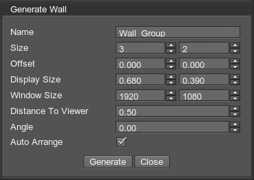

To open the Wall generator select Generate -> Wall in the menu:在菜单中选择Generate -> Wall打开Wall生成器:
The following window will open:将打开以下窗口:
Name Name of the group that is displayed in the left panel of the SpiderVision Setup window.显示在SpiderVision设置窗口左侧面板中的拼接屏名称。
Size Number of rows and columns in the wall grid.拼接屏中的行数和列数。
Offset Vertical and horizontal distance between edges of neighboring viewports, in meters. This value represents a distance between matrices of neighboring monitors, from the edge of one screen to the edge of the other screen.相邻视口边缘之间的垂直和水平距离(单位:米)。该值表示相邻显示器矩阵之间的距离,即从一个屏幕的边缘到另一个屏幕的边缘的距离。
Display Size Physical size of each display in the group. The value is set in meters.组中每个显示器的物理尺寸。该值以米为单位设置。
Window Size Window size of each viewport in the group, in pixels.组中每个视口的窗口大小,单位为像素。
Distance To Viewer Distance between the viewer and the center of the wall grid, in meters.观看者与拼接屏中心之间的距离,单位为米。
Angle
External angle between two neighboring columns of displays, in degrees.相邻两列显示器之间的外部角度,单位为度。
Wall Angle set to 30角度设置为30
Auto Arrange Automatic positioning of windows on the displays. If disabled, all windows are created with the position (0, 0) at the same place and are to be positioned manually.在显示器上自动定位窗口。如果禁用,则所有窗口都在同一位置以位置(0,0)创建,并手动定位。
All these settings, except Size, may be reconfigured later as you select the Wall group parent item in the viewports tab.所有这些设置,除了 Size,都可以在以后的视口选项卡中选择Wall组父项时重新配置。
