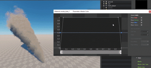

To open Curve Editor, click on the curve preview widget.要打开“曲线编辑器”,请单击“曲线预览”小部件。
A separate Curve Editor window opens for each parameter. The previously opened windows are not closed.每个参数将打开一个单独的Curve Editor窗口。先前打开的窗口未关闭。

The horizontal axis represents the input value, such as life time. The values are normalized and depend on the corresponding value of the node (for example Life Time).横轴表示输入值,例如寿命。这些值已标准化,并取决于节点对应的值(比如 Life Time )。
The vertical axis represents the range of available parameter values. The scale is controlled by Max Value.垂直轴表示可用参数值的范围。比例尺由Max Value控制。
The curve view can be zoomed in and out along both axes by using the scroll wheel, or along either axis individually by using the corresponding display parameter.曲线视图可以通过使用滚轮沿着两个轴放大缩小,也可以通过使用相应的显示参数单独沿着任何一个轴放大缩小
The curve view can be panned by dragging mouse while holding the middle button pressed or holding the Ctrl button and using the cursor keys.按住中间按钮或按住Ctrl按钮并使用光标键,同时拖动鼠标可以平移曲线视图。
If a parameter is adjusted via multiple curves, you can hide some of them via the corresponding checkboxes with color coding.如果参数是通过多条曲线调整的,则可以通过相应的带有颜色编码的复选框隐藏

Curves are edited via keys (points on the curve) by changing their position and manipulating their tangents.通过键(曲线上的点)通过更改曲线的位置和操纵其切线来编辑曲线。
To add a key, right-click on the curve at the point where the key should be placed and select Add key.添加点,请在曲线上的应放置点的位置上单击鼠标右键,然后选择Add key
Removing a key can be performed by right-clicking on it and selecting Remove key.删除点,可以通过右键单击并选择Remove key来执行。
