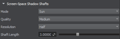

Screen-Space Shadow Shafts Settings#
This set of parameters is used to configure rendering of volumetric Screen-Space Shadow Shafts. Shadow shafts can be rendered for both the Sun and the Moon.
Mode The rendering mode for volumetric screen-space shadow shafts. Shadow shafts (aka light shafts) can be generated in screen space for the Sun and the Moon to simulate the real world effect of crepuscular rays, or atmospheric shadowing of atmospheric in-scattering. These rays add depth and realism to any scene.
  • This effect works for opaque geometry only.
  • It is recommended to use Screen-Space Shadow Shafts with relatively thick haze for visual consistency.
  • Disable this effect for indoor scenes as only world light sources are supported.
One of the following values:
  • Disabled
  • Sun shadow shafts (by default)
  • Moon shadow shafts
  • Sun and Moon shadow shafts
Console access: render_screen_space_shadow_shafts_mode (API control)
Quality The quality of screen-space shadow shafts. Defines the number of steps to be used when generating the texture for this effect. Lower quality values may result in noticeable banding effect especially in case of long shadow shafts. Medium quality is usually enough, but you can increase it if shafts are long enough and banding effect becomes noticeable. One of the following values:
  • Low - low quality
  • High - high quality
  • Ultra - ultra quality
Console access: render_screen_space_shadow_shafts_quality (API control)
Resolution The resolution of the texture to which screen-space shadows are rendered. One of the following values:
  • Full - full resolution
Console access: render_screen_space_shadow_shafts_resolution (API control)
Shaft Length The length of volumetric screen-space shadow shafts.
Range of values: [0.0f, 100.0f]. The default value is : 3.0f.
Console access: render_screen_space_shadow_shafts_length (API control)

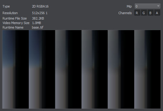

Base#
A 2D texture defining the base color of the sky, clouds, and haze.
Base LUT Texture
Base LUT Texture

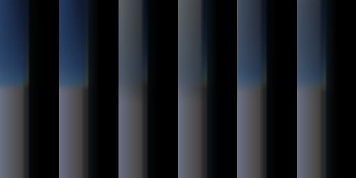

The texture consists of 6 columns, each for a specific reason:
  1. Color of the sky on the side opposite to the light source (to provide a possibility of rendering a shadow cast by a planet, if required)
  2. General sky color
  3. Color of clouds on the side opposite to the light source (to provide a possibility of rendering a shadow cast by a planet, if required)
  4. General clouds color
  5. Color of haze on the side opposite to the light source (to provide a possibility of rendering a shadow cast by a planet, if required)
  6. General haze color
The use of texture also depends on the Scattering mode of the active World light source. For the Sun scattering mode, the left side of each column is used:
  • Left to right: the position of the Sun above the surface (time of day).
  • Top to bottom: the gradient of the Sun.
For the Moon scattering mode, the right side of each column is used.

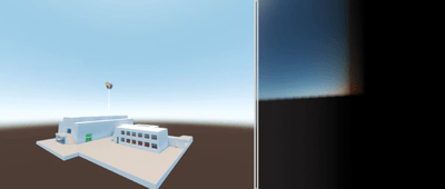

Sampling the Base LUT texture for the general sky color based on the sun angle
If the default LUT doesn't meet the visual requirements of your project, you can customize it using a third-party image editor to achieve the desired effect by selectively adjusting specific areas of the LUT texture. The image below illustrates how the base LUT texture was edited to produce a clearer and more saturated sky with reduced haze:
In the upper sections of the texture, blue tones were intensified for a deeper sky color (columns 1 and 2) and less intense haze (columns 5 and 6). Mid-to-lower regions were shifted downward to reduce grayish haze near the horizon.
We do not recommend repainting or restructuring the LUT texture since it can result in incorrect atmospheric rendering, visible seams, or unnatural transitions. Instead, focus on adjusting color balance, saturation, brightness, or contrast only.
To Apply the Customized LUTs
  1. Extract the original base.tif LUT texture from your project. For example, you can do it the following way: in the Environment -> Scattering LUT settings window, click the magnifying glass icon next to the Base slot to locate the file and copy it to the /data folder of your project in the Asset Browser.
  2. Then using SDK Browser click Open Folder in your project's card and open the base.tif file in your preferred third-party image editor. Make the desired adjustments and save the file in the same .tif format. The file name can be different if needed.
  3. Import the customized LUT texture file into your project via the Asset Browser.
  4. Go to Windows -> Settings -> Environment -> Scattering LUT and assign the texture to the Base slot.

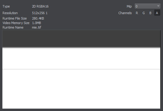

The Alpha channel stores the mask for the celestial body texture.
Alpha Channel of Mie LUT Texture

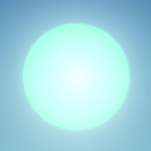

To simulate dense cloudiness without a visible celestial body (the Sun or the Moon), paint the Alpha channel black.
The result of using different masks in the Alpha channel

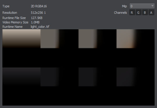

Light Color#
A 2D texture defining the color of LightWorld depending on the time of day.
Light Color LUT Texture
The texture is split vertically (top for the Sun and bottom for the Moon scattering mode) and consists of 4 columns, each for a specific reason:
  1. Color to be used for objects in the world. The values in this column should differ only vertically, horizontally the value should be the same.
  2. Color to be used for clouds on the side opposite to the light source (to provide a possibility of rendering a shadow cast by a planet, if required)
  3. Color to be used for clouds
  4. Color to be used for clouds around the light source

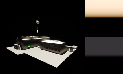

Sampling of the color for objects based on the sun angle (the black texture is used for the Base and Mie LUTs for clarity):

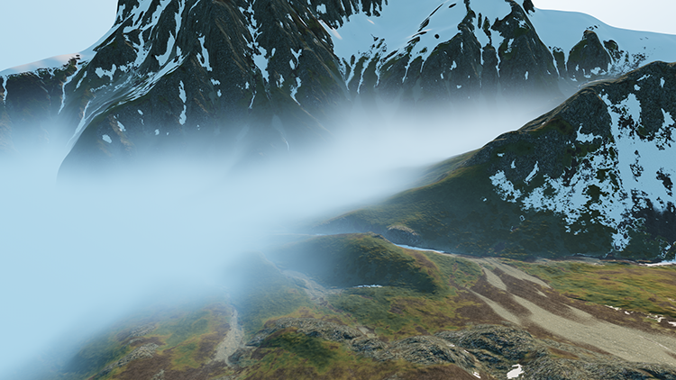

Haze Settings#

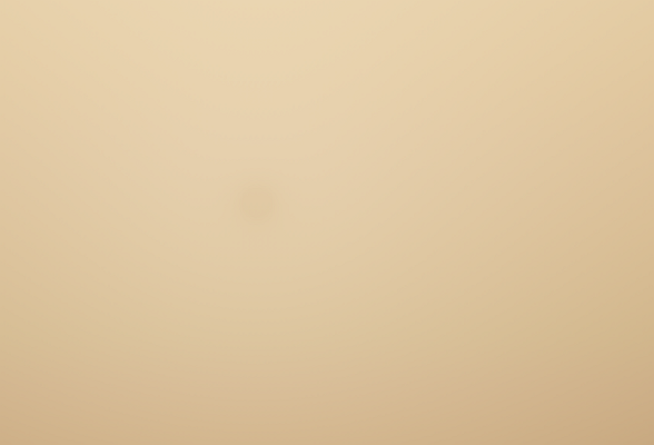

Physically based haze
This group of parameters set the atmosphere haze. It automatically uses the color from the scattering LUTs, so objects smoothly fade into the distance without any artifacts.
Haze Settings
In some cases, the configuration of the default environment presets is not suitable for dense fog simulation and might require some adjustment.

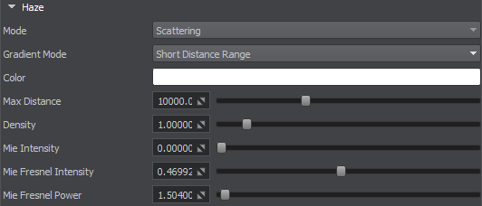

Mode The mode for the haze effect.
  • If Disabled, no haze is applied.
  • The Solid mode uses the solid color from the Color parameter.
  • The Scattering mode uses the color from the sky LUTs is blended with the Color parameter. This value is recommended for better realism: objects will smoothly fade into the distance.
Option #3 is selected by default (see above).
Console access: render_environment_haze (API control)
Gradient Mode The environment haze gradient mode. By using this option, you can make the haze look more realistic for a specific distance range.
  • Short Distance Range — better suitable for near-surface haze
  • Long Distance Range — better suitable for hazy mountains
  • Physically Based — for physically based haze simulation
Console access: render_environment_haze_gradient (API control)
Color
The color of the haze. This value can be specified for both the Solid and Scattering haze modes: in the first case, the color will be used as is, in the second case, the color will be blended with the color from the sky LUTs.
Max Distance The distance starting at which the haze becomes completely solid, so nothing will be seen behind. For large terrains it is recommended to set this parameter equal to your camera's Far parameter. This is required for distant objects to fade into the distance instead of being cut sharply.
Density The density of the haze.
Mie Intensity Minimum Mie intensity value for geometry-occluded areas. This value specifies the fraction of Mie intensity visible when the surface is viewed from straight on. Setting this value to 1 disables the Fresnel effect. You can use this parameter together with Mie Fresnel Intensity and Mie Fresnel Power to control light occlusion from World light sources. Works for both, opaque and transparent objects.
Mie Front Side Intensity Falloff of the Fresnel effect for Mie intensity. This parameter enables you to control occlusion of light from a World light source by the geometry.
Mie Fresnel Power The power of the Fresnel effect for Mie visibility. Higher values will tighten up the areas affected, while lower ones will allow more areas to be affected by the Fresnel effect.

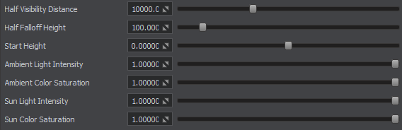

Physically Based Haze Calculation Parameters#
This group of parameters is used for physically based calculation of the haze gradient.
In most cases there is no need to adjust default haze settings here. However, if you want to change haze color (e.g., make it a bit more bluish) we recommend you doing it via the Color multiplier above instead of tweaking Color Saturation for sunlight and ambient lighting, as this may cause problems with colors at sunset.
Half Visibility Distance Distance at which the visibility comprises 50%. There is no zero-visibility in the real world, so the half-visibility boundary is used to adjust haze distance.
Half Faloff Height Height of the haze density gradient. The higher the value, the longer the haze desity reduces as the height grows, making the transition between the clear sky and haze smoother.
Start Height Reference height value for the two parameters above (Half Visibility Distance and Half Faloff Height).
Ambient Light Intensity Intensity of the impact of ambient lighting on haze (how much ambient lighting affects the haze).
Ambient Color Saturation Intensity of the ambient color's contribution to the haze (how much the haze color is affected).
Sun Light Intensity Intensity of the impact of the sunlight on haze (how much the sunlight affects the haze).
Sun Color Saturation
Intensity of the sunlight color's contribution to the haze (how much the haze color is affected).
"Sunlight color" here does not simply mean the color multiplier of the WorldLight source, but rather the Light Color in the Scattering LUT section above.

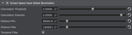

Screen-Space Haze Global Illumination (SSHGI) is a screen-space effect ensuring consistency of haze color with the current color of Global Illumination. Available for Physically Based haze gradient mode only.
Screen-Space Haze Global Illumination Toggles the value indicating if the Screen-Space Haze Global Illumination effect is enabled.
Colorization Threshold The treshold value for scene depth used when setting haze color for the SSHGI effect in "information lost" areas on the screen.
  • 0 - haze color is defined only by surfaces currently visible on the screen.
  • 1 - haze color is defined by surfaces everywhere, even in "information lost" areas.
Console access: render_environment_haze_colorization_threshold (API control)
Colorization Intensity The colorization intensity value that defines haze color in "information lost" areas on the screen.
  • 0 - haze in "information lost" areas will have the initial color (same as it would be without SSHGI).
  • 1 - haze in "information lost" areas will have the less bright color among the two, initial color and haze color with SSHGI correction.
This parameter is ignored when Colorization Threshold is set to 1, as there will be no "information lost" areas not covered by SSHGI.
Range of values: [0.0f, 1.0f]. The default value is : 0.95f.
Console access: render_environment_haze_colorization_intensity (API control)

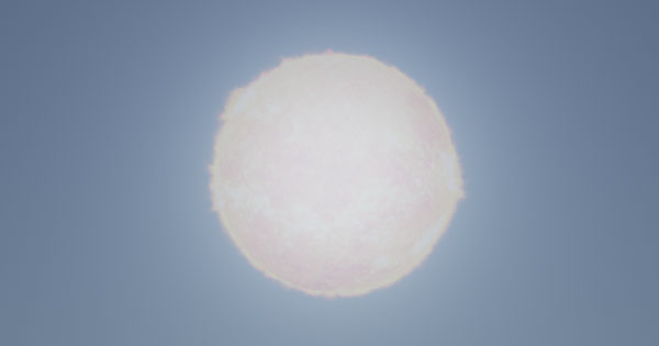

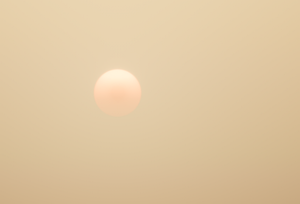

A texture that sets the Sun in the sky. On the picture below, the Sun Size is increased to demonstrate how the textures are applied:
The texture may also be used to imitate the extremely bright area around the light source.

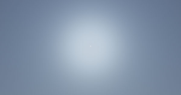

A texture that sets the Moon in the sky. On the picture below, Moon Size and Moon Intensity are increased to demonstrate how the textures are applied:
