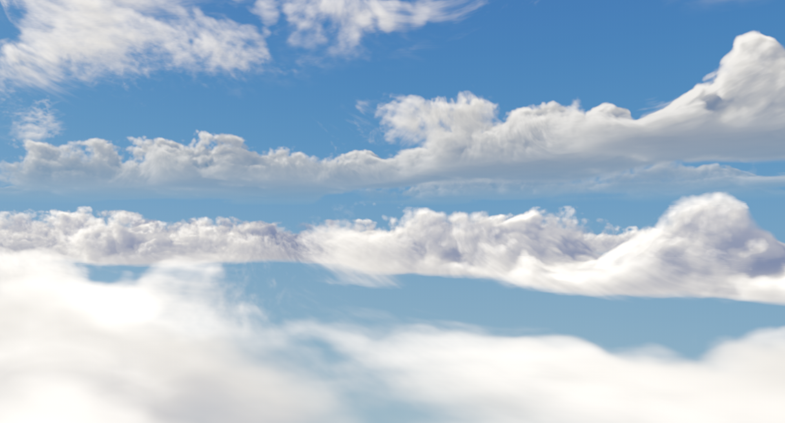

Avoid using volumetric clouds (Cloud Layer objects), unless there is no other option and it is a critical requirement for your project. They are very expensive at high resolutions as they simulate realistic lighting and shape of the clouds in real-time. If you still need to use volumetric clouds, it is recommended to set the Downsampling Rendering parameter to Quarter or Half. It is also recommended to enable Interleaved Rendering mode, when clouds are viewed from the ground, or from above (at significant distance), but be aware that quick and sudden movements may result in noticeable cloud graininess. 避免使用体积云 Cloud Layer对象),除非没有其他选择,并且这对您的项目是至关重要的。它们在高分辨率下非常昂贵,因为它们可以实时模拟逼真的照明和云的形状。如果仍然需要使用体积云,建议将Downsampling Rendering参数设置为QuarterHalf。当从地面或从上方(远距离)观察云时,也建议启用Interleaved Rendering模式,但请注意,快速而突然的移动可能会导致云的明显颗粒感。
When volumetric clouds are not required, it is better to use one of the following options:不需要体积云时,最好使用以下选项之一:
  • Just set an HDRI panorama via the Environment settings.只需通过Environment设置即可设置HDRI全景图。
    If your project requires changing the time of the day, this can be done by blending Environment Presets, and thus smoothly replacing one HDRI texture (for the day-time sky) with another (for the evening).如果您的项目需要更改一天中的时间,则可以通过混合“环境预设”来完成,从而用一种HDRI纹理(用于白天的天空)平滑地替换为另一种(用于夜间)的HDRI纹理。
  • Use a Sky object with an HDRI texture and 2D clouds option enabled.使用启用了2D clouds选项的Sky2D clouds对象。
Dynamic procedural environment, although being performance friendly, does not come completely for free. You can disable it via Rendering -> Features -> Environment in the main menu and use a Sky object with an HDRI texture instead. This will actually look better and give you a bit more performance, however, in this case you'll have no haze at the horizon, as it is a part of Environment.动态过程环境虽然性能友好,但并非完全免费。您可以通过主菜单中的Rendering -> Features -> Environment禁用它,而可以使用带有HDRI纹理的Sky对象。这实际上看起来会更好,并且可以为您带来更多性能,但是,在这种情况下,由于环境是环境的一部分,因此您不会感到茫然。
