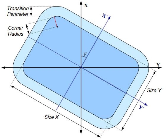

void setSize ( const vec2 & size ) #
Sets the length of the rounded bounding rectangle of the weather region along its X and Y axes (represented by X' and Y' ), respectively.
This method is not available for weather layers (region type = 0).
Arguments
  • const vec2 & size - Vector with two components representing length (in meters) of the rounded bounding rectangle of the weather region along its X and Y axes respectively.
void setSize ( const vec3 & size ) #
Sets the length of the rounded bounding rectangle of the weather region along its X, Y, and Z axes respectively.
Arguments
  • const vec3 & size - Vector with three components representing length (in meters) of the rounded bounding rectangle of the weather region along its X, Y, and Z axes respectively.
void setPosition ( const Vec2 & pos ) #
Sets geographic location of the rounded bounding rectangle of the weather region.
Arguments
  • const Vec2 & pos - Vector with two components representing latitude and longitude of the center of the rounded bounding rectangle of the weather region respectively. The origin of the region’s local coordinate system is at this point.
void setPosition ( const Vec3 & pos ) #
Arguments
  • const Vec3 & pos - Vector with three components representing latitude, longitude, and altitude of the center of the rounded bounding rectangle of the weather region respectively. The origin of the region’s local coordinate system is at this point.
