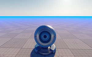

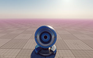

Background Color Color rendered on the scene background. The color has an alpha channel that sets transparency of the background: the lower the value of the alpha channel is, the more transparent and, therefore, the darker the background color is. For example, the parameter allows creating colored transparent background instead of rendering an environment cubemap. However, if the environment cubemap is rendered, the background color will always be rendered over the environment. For example, it can be used to create brighter, richer sky colors with light scattering.

Default Background Color
Blue background color
Blue Background
