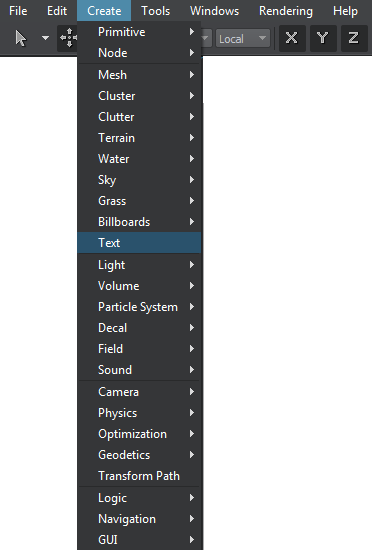

To add a text object to the scene via UnigineEditor, do the following:
  2. On the Menu bar, click Create -> Text.
  3. Place the text object somewhere in the world.

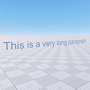

Wrap Width Text wrap width in units. The text will wrap if its physical size will be greater than the set value. If 0 is set, text wrapping is disabled.
Wrap Width = 0
Wrap Width = 5

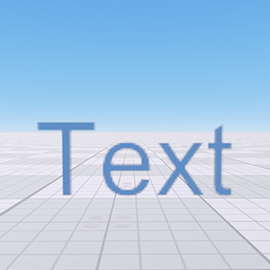

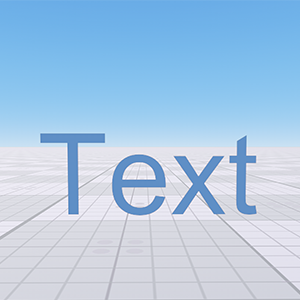

Resolution Resolution of the texture into which the text will be rendered. The lower the value, the less detailed will be the text and the less video memory will be required for the texture.
The resolution doesn't influence the text's physical size.
Resolution = 50
Resolution = 200
