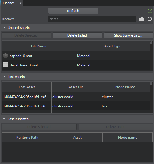

Cleaner checks each asset that your project contains and displays irregularly used assets.
To open the Cleaner window, choose Tools -> Cleaner on the Menu Bar of UnigineEditor.
The Cleaner window will open:
Unused Assets#
This tab displays the assets that are not used in any of the files included in your project (worlds, layers, nodes, meshes, materials) and not referenced from code in any of your source files stored in your project source/ folder, but still exist in the project.
Cleaner shows the file name and asset type for unused assets. As you click an unused asset in Cleaner, it is displayed in the Asset Browser and the Parameters window.
You can delete any or all of the displayed assets by using the Cleaner functionality.
The Unused Assets list also includes all assets that were referenced from the unused assets.
- Delete Selected — deletes only the selected assets from the list of unused assets. This option is also available by right-clicking the selected files in Cleaner.
Delete Listed — deletes the whole list of currently displayed assets.
WarningUse delete buttons carefully. Deleted assets cannot be restored. -
Show Ignore List... — displays the ignore list that already contains the default list of wildcards used to exclude files from the check by Cleaner. This list can be extended by the user.
WarningIf a filename in your project is generated in code (for example, a string concatenated from several words), add such cases to the Ignore List. Otherwise, such files will be deleted.Upon clicking the Check button, all project files to be ignored by Cleaner are displayed in the bottom part of the Ignore List window.
Lost Assets#
This tab displays the assets referenced to by GUID but are not available in the project.
As you click a lost asset, the asset containing a reference to it, is displayed in the Asset Browser and the Parameters window. Fixing of lost assets is possible only manually.
The table in the Lost Assets tab has three columns:
- Lost Asset — shows the GUID of the lost asset.
- Asset File — shows the name of the file containing the reference to the lost asset.
- Node Name — shows the name of the node, if the file containing the reference includes the node that actually has a reference to the lost asset.
Lost Runtimes#
This tab displays the runtime files generated for the assets that are not available in the project, but referenced by a node/nodes in the scene.
The table in the Lost Runtimes tab has three columns:
- Runtime Path — shows the path to the lost runtime file.
- Asset — shows the name of the file containing the reference to the asset, for which the lost runtime file was generated.
- Node Name — shows the name of the node, if the file containing the reference includes the node that actually has a reference to the asset, for which the lost runtime file was generated.
