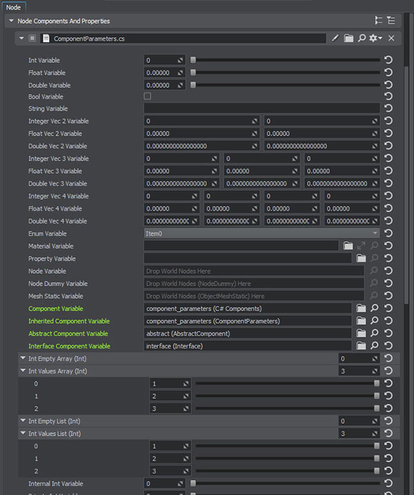

Component Parameters#
The example demonstrates possible variations of component parameters.
Select the component_parameters Node Dummy in the Editor and check the parameters window.
It will contain all types of parameters.
SDK Path: <SDK_INSTALLATION>data/csharp_component_samples/systems/components_parameters
