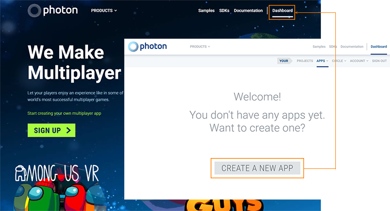

  3. Create App IDs.
    Go to Dashboards (the tab in the top right corner).
    In the Dashboards section, click CREATE A NEW APP.
    You need to create two applications for Photon sample: one using Realtime Photon SDK, and the other one — Chat Photon SDK.
    Creating a Realtime Photon App
    Creating a Chat Photon App
    Now you have two apps and may use their IDs in the sample. The same ID is used for every instance (i.e. other participants don't need to create their own apps).
