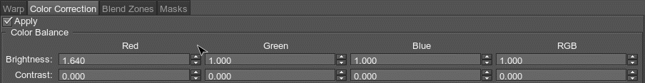

Color and Brightness Correction#
The Color Correction tab allows you to correct color intensity, as well as to adjust color balance for the selected projection.
Brightness
Per-channel color multiplier to control the intensity of:
  • Red
  • Green
  • Blue
  • RGB at once
Red channel scale
Brightness for the red channel = 2
Contrast
Settings that allow you to adjust the color balance per channel (as well as for all channels at once):
  • Positive values are added to the color values on the screen.
  • Negative values are subtracted from color values on the screen.
Red channel bias
Contrast for the red channel = -0.1
Brightness (corners) Settings to adjust brightness compensation for each of the projection's corners individually.
All Color Balance parameters can be reset to defaults by clicking the corresponding parameter name (by line or by column).
