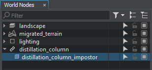

The generated impostor(s) will be added as a child node to the original mesh/clutter:
  • For objects baked into the clutter, the Mesh Clutter object with the <node_name>_impostor_material will be added. All required settings will be copied from the original Mesh Clutter automatically.
    Real Clutter Objects and Its Impostors in Scene
    Objects and Impostors Wireframes
  • For a single object, the Mesh Static object with the material inherited from <node_name>_impostor_material will be added.
    Real Object (left) and Its Impostor (right) in Scene
    Object and Impostor Wireframes
