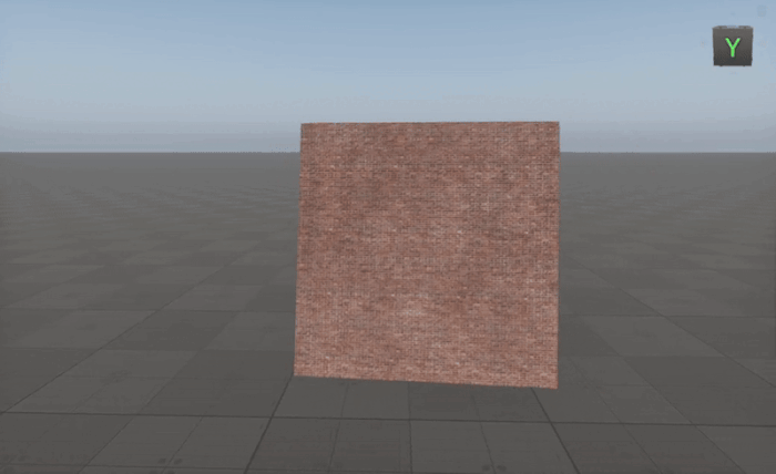

Creating A Material Always Facing The Camera
Normalization is a crucial step when working with vectors. Skipping normalization can result in incorrect material behavior due to changes in camera vector length, leading to miscalculations.
For example, if we want to create an object always facing the camera, we need to construct a local coordinate system based on the camera's position relative to the object.
Since the Cross node calculates the perpendicular vector by multiplying two input vectors, without normalization, their varying lengths will cause unpredictable material transformation, making the object change in size depending on the camera position. To avoid this, always normalize vectors before performing such calculations.
