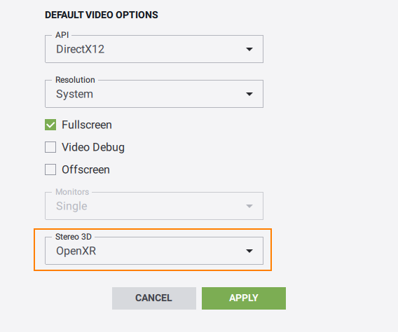

By default, VR is not initialized. So, you need to perform one of the following:
  • If you run the application via UNIGINE SDK Browser, set the Stereo 3D option to the value that corresponds to the installed HMD (OpenXR, OpenVR or Varjo) in the Global Options tab and click Apply.
  • When running the application from the command line, you must specify the desired VR runtime backend using the -vr_app command line option on the application start-up.
    Shell commands
    your_app_name -vr_app <backend>
    The following backends are supported:
    • openxr - for devices compatible with the OpenXR standard.
    • openvr - for devices running via OpenVR-compatible runtimes.
    • varjo - for use with Varjo headsets via the Varjo SDK.
    For example:
    Shell commands
    your_app_name -vr_app openxr
    Alternatively, you can specify this command-line option in the Customize Run Options window when running the application via the SDK Browser:
