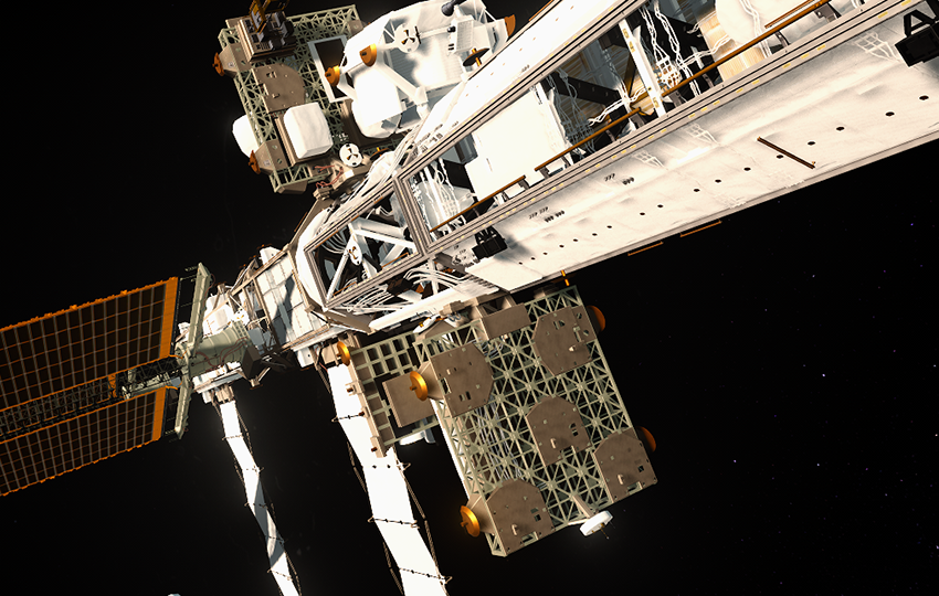

ISS without TAA.
ISS with TAA.

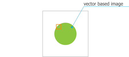

During rasterization process, there is a test whether the object will get into pixel or not. And the object will not be rendered if it doesn't occupy a major part of a pixel.
Vector image before rasterization.

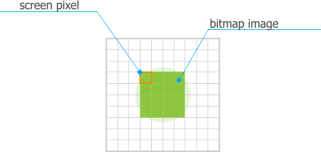

And here we can get an error, when we have a sphere object before rasterization and get a square object after, because some parts of the sphere doesn't occupy enough pixel space.
Bitmap image after rasterization without TAA.

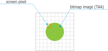

Not a very good rendering, right? And temporal anti-aliasing solves this problem, because camera will have a sub pixel jitter, and each part of this sphere at least once will be rendered in a frame. And after combining these frames, we will get a true sphere, not a square! Voila!
Bitmap image after rasterization with TAA.
