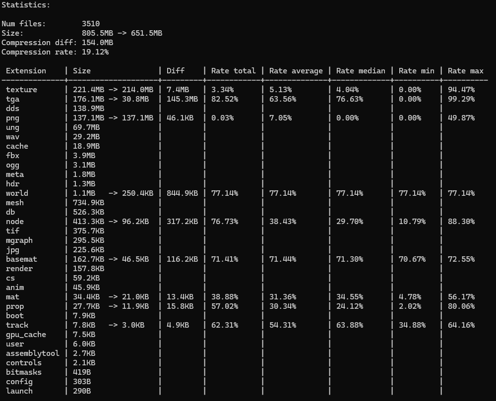

The following prints statistics related to the archive:
Shell commands
ung_x64 -i files.ung
