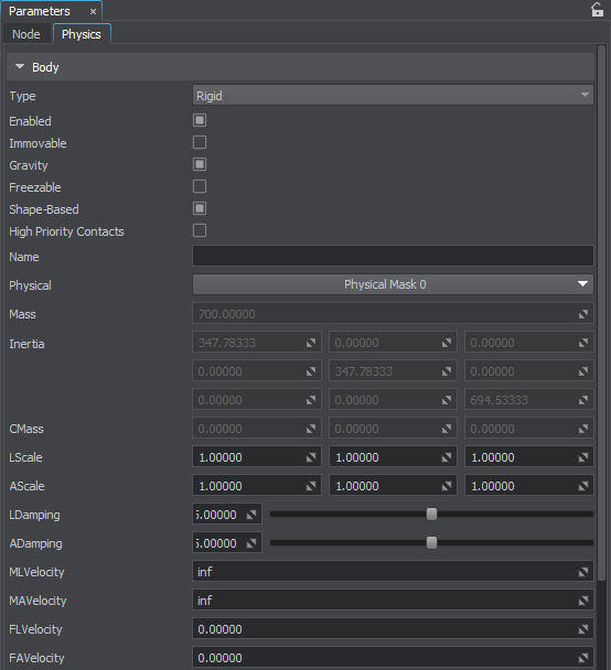

To enable this option for a body via UnigineEditor perform the following steps:
  1. Select the desired object with a Rigid body assigned.
  2. Go to the Physics tab in the Parameters window.
  3. In the Body section, check the Shape-based option.

Disabling the Shape-based option makes it possible to manually redefine some total parameters for the body.
To disable this option for a body via UnigineEditor perform the following steps:
  1. Select the desired object with the Rigid body assigned.
  3. In the Body section, check Shape-based option. The fields of total parameters for the body will be activated.
  4. Set up body parameters manually.

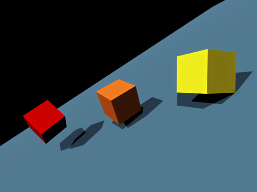

For example, the following illustration shows three boxes with different inertia tensors. The yellow box has very high inertia:
100         0         0
    0     100         0
    0         0     100
Because of that, it can only slide down when falling upon the tilted plane. The red box, on the contrary, has the lowest inertia and rotates most eagerly.
