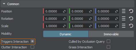

Some "abstract" objects do not have bounds; therefore, they do not interact with World Trigger (regardless of the Triggers Interaction option state):
World Trigger affecting meshes
