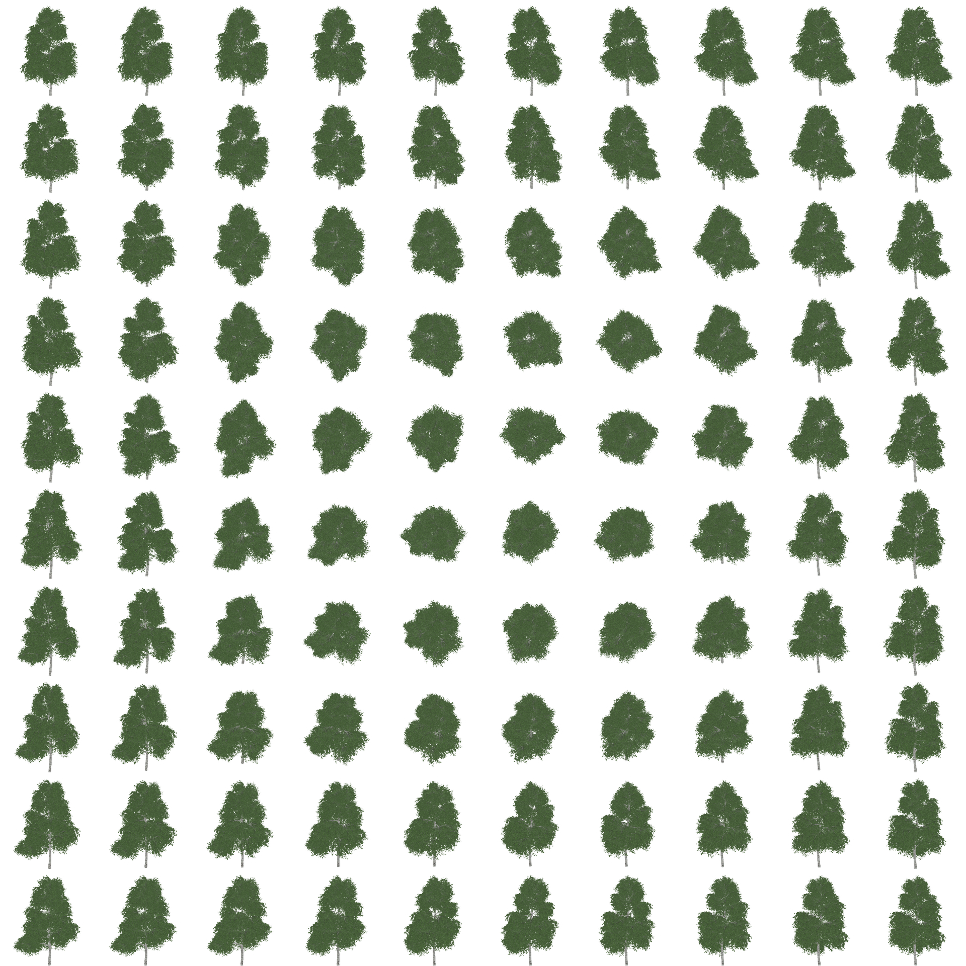

Atlas Size
The size of the created atlas texture that stores all captured images. Atlas is always a square texture.
Altas size 10x10
