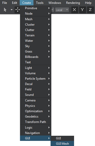

To add the GUI Mesh:要添加GUI Mesh
  1. Run the project with UnigineEditor.跑步UnigineEditor的项目。
  2. On the Menu bar, click Create -> GUI -> GUI Mesh.在菜单栏上,单击Create -> GUI -> GUI Mesh
  3. Specify a mesh on which the GUI will be rendered.指定将在其上呈现GUI的网格。
  4. Place the GUI Mesh in the world and specify the required parameters for it.GUI Mesh放置在世界上,为其指定所需的参数
  5. In the script, get the GUI object via the World.getNodeByName() (or World.getNodeByID() if you have the node index) and assign a widget to it by using functions of the ObjectGuiMesh class.在脚本中,通过World.getNodeByName()(或拥有节点索引的World.getNodeByID() if)获取GUI对象,并使用ObjectGuiMesh类的函数为其分配小部件。

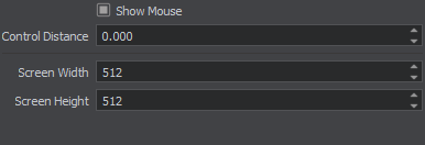

In the Gui Mesh section of the Node tab, you can adjust the following parameters of the GUI Mesh:Node选项卡的Gui Mesh部分中,可以调整GUI Mesh的以下参数:
Node tab, Gui Mesh sectionNode标签,Gui Mesh部分
Show Mouse Indicates if the mouse cursor should be rendered in the GUI Mesh.指示是否应在GUI Mesh中呈现鼠标光标。
Control Distance Distance at which the GUI Mesh becomes controllable.GUI Mesh可控制的距离。
Screen Width Width of the GUI object in pixels.GUI对象的宽度(以像素为单位)。
Screen Height Height of the GUI object in pixels.GUI对象的高度(以像素为单位)。
