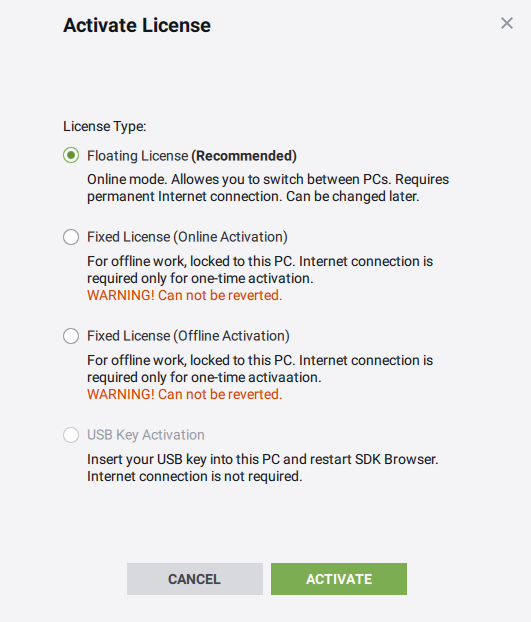

After you have installed an SDK, the Activate License window opens:安装 SDK 后,激活许可证窗口将打开:
License activation types are available depending on your license. If a certain license activation type is not available as supposed, contact the person who is assigned the role of Company Admin for assistance.许可证激活类型取决于您的许可证。如果某个许可证激活类型不可用,请与分配Company Admin角色的人员联系以寻求帮助。

To activate a product with this type of activation, select the Floating License type in the Activate License window that appears immediately after the product has been installed:要使用这种激活类型激活产品,请在安装产品后立即显示的Activate License窗口中选择Floating License类型:

To activate a product with this type of activation, select the Fixed License (Online Activation) type in the Activate License window that appears immediately after the product has been installed:要使用这种激活类型激活产品,请在安装产品后立即显示的Activate License窗口中选择Fixed License (Online Activation)类型:

  4. In the window that opens choose Fixed License (Offline Activation).在打开的窗口中选择Fixed License (Offline Activation)
    The Offline Activation form will open:Offline Activation表单将打开:
