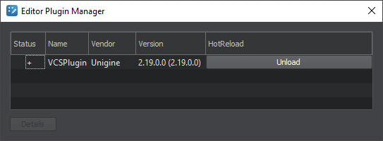

Similar to other plugins, this plugin can be loaded and unloaded via the Editor Plugin Manager window. When the plugin is loaded and running, it receives data about every event in the Asset System (asset or directory adding, deleting, renaming, moving, or asset editing).与其他插件类似,这个插件可以通过 Editor Plugin Manager 窗口加载和卸载。 当插件加载并运行时,它会接收资源系统中每个事件的数据(资源或目录的添加、删除、重命名、移动或编辑)。

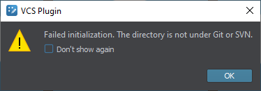

  4. Ensure the version control system (SVN, Git) manages your project. Otherwise, an error message will appear when launching UnigineEditor.确保版本控制系统(SVN, Git)管理您的项目。 否则,启动UnigineEditor时会出现错误消息。

  1. Select Windows -> Editor Plugin Manager in the Menu Bar.在菜单栏中选择 Windows -> Editor Plugin Manager
  2. Find VCSIntegration Plugin in the list and click Unload.在列表中找到 VCSIntegration 插件 并单击 Unload
After that, the plugin will be disabled until the Editor is restarted or the Load button is clicked.之后,插件将被关闭,直到重新启动编辑器或单击 Load 按钮。
