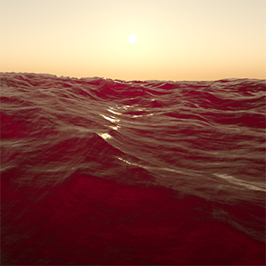

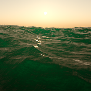

The transparency of the underwater fog. The higher the value, the more transparent the underwater fog is.
Fog Transparency: 5.0
Fog Transparency: 30.0

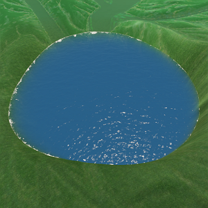

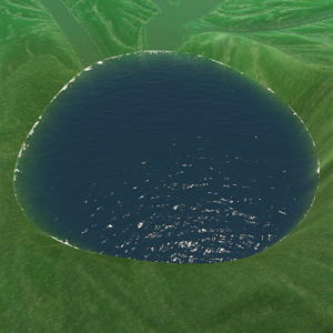

Distance Fade
Distance from the water surface downwards, at which light shapes fade, in units.
Distance Fade: 20.0
Distance Fade: 40.0
