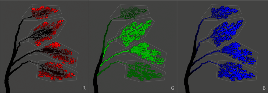

Vegetation movements are defined by RGB channels of vertex colors as follows:植被运动由顶点颜色的RGB通道定义如下:
Red channel is used for animation of smaller or peripheral parts of vegetation (leaves). Bright parts are animated, and dark parts are stiff.红色通道用于较小或外围植被部分(树叶)的动画。明亮部分被动画化,暗部分僵硬。
Green channel is used to define the movement order for branches in order to desynchronize them. The movement sequence starts from the brightest element to the darkest.绿色通道用于定义树枝的运动顺序以使其不同步。运动序列从最亮的元素开始到最暗的元素。
Blue channel is used to define which parts of branches can be bent. Brighter parts indicate bendable portions, and darker parts — stiff portions.蓝色通道用于定义树枝的哪些部分可以弯曲。较亮的部分表示可弯曲的部分,较暗的部分表示僵硬的部分。

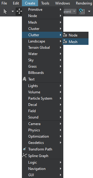

  1. Click Create -> Clutter -> Mesh and specify the .mesh asset to be used as the source mesh for the Mesh Clutter. Click within the viewport to place the new node in the world.单击 Create -> Clutter -> Mesh 并指定要用作 Mesh Clutter 的源网格的 .mesh 资源。在视口中单击以将新节点放置在世界中。

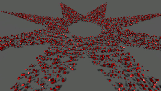

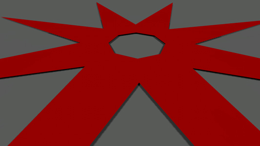

    • As an additional feature, masking by a mesh is also available:您还可以通过使用网格进行掩码
    • Cutout by intersection with objects:通过与对象相交进行裁剪:
      1. Create Mesh Static or Decal representing a bounding cutout volume. Enable the Clutter Interaction flag for it.创建表示裁剪体积边界的 Mesh StaticDecal,并启用 Clutter Interaction 标志。
