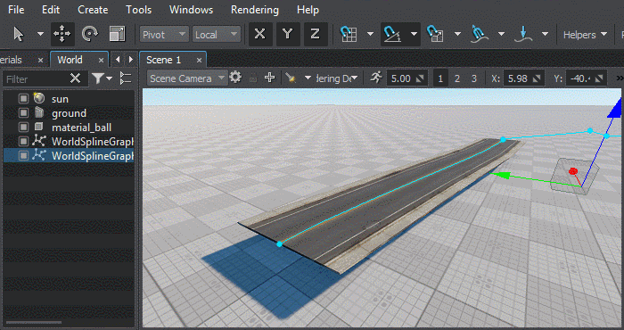

  4. Use the Move manipulator as you would do to move a node (the form of the corresponding segment will change).

Up vector controls orientation of nodes placed along the spline segment. To adjust tangent at a point do the following:
  1. Select the world spline graph.
  2. Select the desired point (Move manipulator will appear).
  3. Select the desired UP vector (in case the selected point is shared by multiple segments, several UP vectors will be displayed for it).
  5. Use the Move manipulator as you would do to move a node (the form of the corresponding segment will change).
