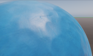

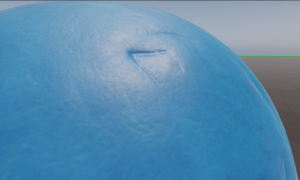

Original normal map Two maps
(Add node)

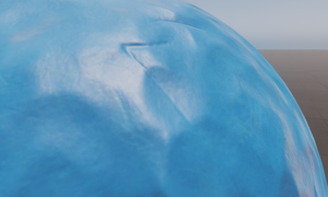

Two maps
(Reorient Normal Blend node)
