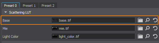

Scattering LUT Settings#
All the presets settings are identical. The scattering versatility is achieved mostly because of the scattering LUT textures.

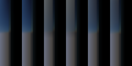

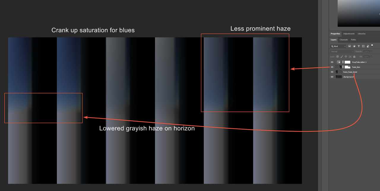

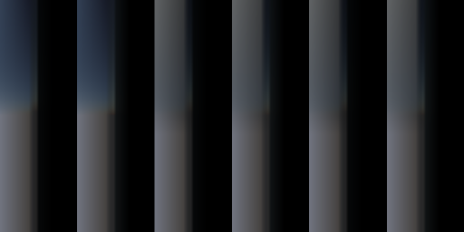

Base#
A 2D texture defining the base color of the sky, clouds, and haze.
Base LUT Texture
Base LUT Texture
The texture consists of 6 columns, each for a specific reason:
  1. Color of the sky on the side opposite to the light source (to provide a possibility of rendering a shadow cast by a planet, if required)
  2. General sky color
  3. Color of clouds on the side opposite to the light source (to provide a possibility of rendering a shadow cast by a planet, if required)
  4. General clouds color
  5. Color of haze on the side opposite to the light source (to provide a possibility of rendering a shadow cast by a planet, if required)
  6. General haze color
The use of texture also depends on the Scattering mode of the active World light source. For the Sun scattering mode, the left side of each column is used:
  • Left to right: the position of the Sun above the surface (time of day).
  • Top to bottom: the gradient of the Sun.
For the Moon scattering mode, the right side of each column is used.
Sampling the Base LUT texture for the general sky color based on the sun angle

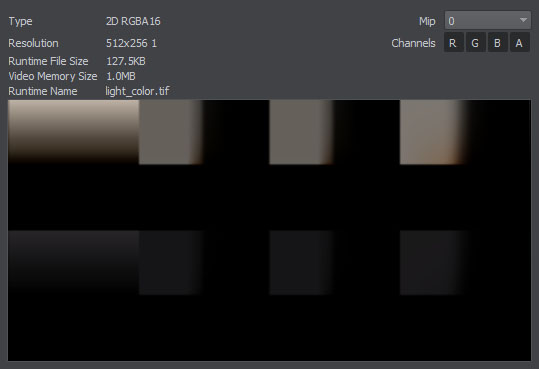

Light Color#
A 2D texture defining the color of LightWorld depending on the time of day.
Light Color LUT Texture
The texture is split vertically (top for the Sun and bottom for the Moon scattering mode) and consists of 4 columns, each for a specific reason:
  1. Color to be used for objects in the world. The values in this column should differ only vertically, horizontally the value should be the same.
  2. Color to be used for clouds on the side opposite to the light source (to provide a possibility of rendering a shadow cast by a planet, if required)
  3. Color to be used for clouds
  4. Color to be used for clouds around the light source
Sampling of the color for objects based on the sun angle (the black texture is used for the Base and Mie LUTs for clarity):

The texture may also be used to imitate the extremely bright area around the light source.
Sun Color
Color multiplier for the Sun texture in the RGBA format. By default, the color is white.
Moon Color
Color multiplier for the Moon texture in the RGBA format. By default, the color is white.
Sun Size Angular size of the Sun in degrees. The value is set for an observer on the Earth. By default, the size of the Sun is 0.5 degrees as seen from the Earth.
Moon Size Angular size of the Moon in degrees. The value is set for an observer on the Earth. By default, the size of the Moon is 0.5 degrees as seen from the Earth.
Sun Intensity
Intensity multiplier for the Sun texture. It allows increasing/reducing brightness of the Sun.
Moon Intensity
Intensity multiplier for the Moon texture. It allows increasing/reducing brightness of the Moon.
